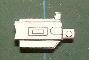

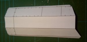

I attached a few greebles that I forgotten on the front section of the main body.
FOOD FOR THOUGHT WHEN BUILDING THIS MODEL. YOU DO NEED TO LOOK AHEAD AT THE INSTRUCTIONS AND SEE IF THERE ARE ANY PARTS THAT ARE ATTACHED LATER ON THAT YOU CAN ATTACH NOW.
Here are the photos.

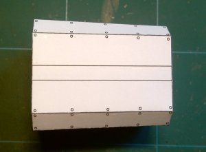

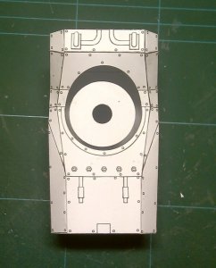

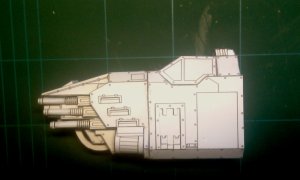

Main turret section of the main body.

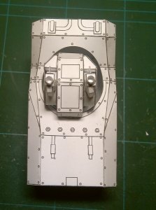

It is time for another update.
Here is the turret section of the main body.
As you can see, there even more greebles. The designer does like greebles.:thumb:

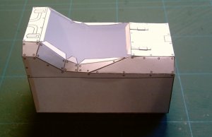

This is what will hold the main turret in the plane.
ENJOY!!!

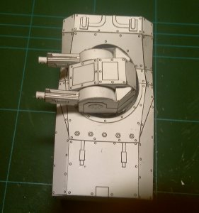

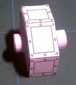

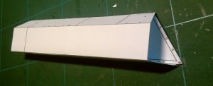

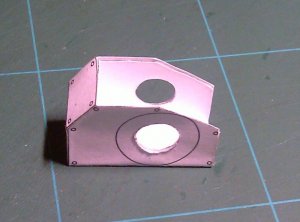

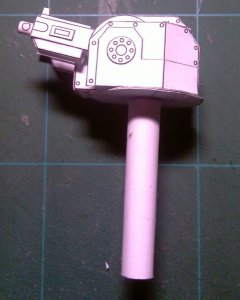

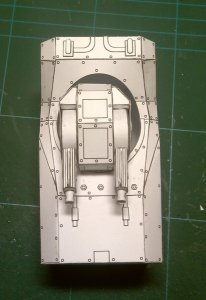

More photos
Here are more photos of the main turret section of the main body and the assembly of the main turret.

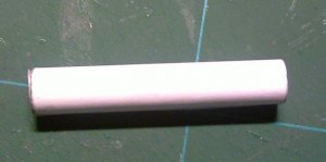

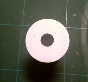

Top of the tube that the main turret will be mounted on.

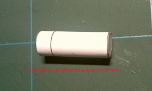

Swivel mounts for the guns.
Axle for the gun mounts. I extended the length to 27 mm. so it can hold the gun mounts properly.
Main turret.
Main turret with axle.

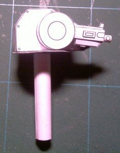

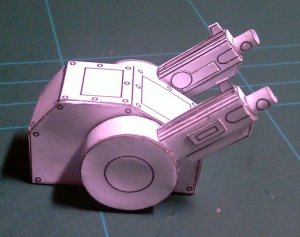

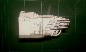

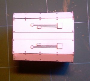

Gun turret assembly
I am continuing the Main turret section. Here is the gun turret assembly.
I did not have any problems with the assembly.
This gun system has quite a few greebles to it. For those who like to add even more detail, there is room for a little more.

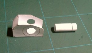

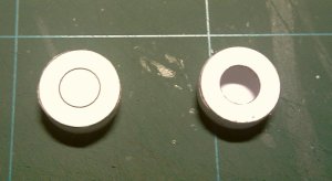

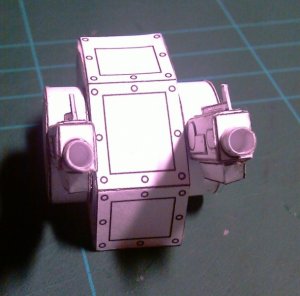

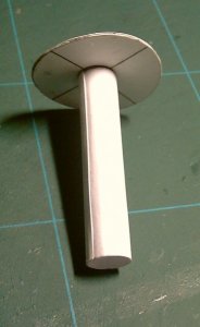

More photos

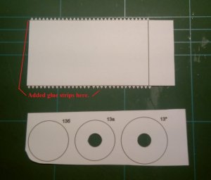

Here are more photos of the gun turret assembly.

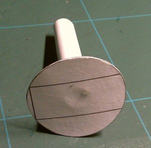

I had to make a spindle that would attach to the turret plate to make the gun turret swivel.
The dimensions of the spindle are 40mm long by 35mm wide (the 5mm part of the width is used for a glue tab.)
The rest of the assembly went together with out any problems.

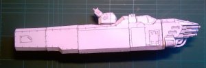

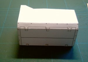

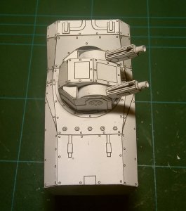

Finished main turret section of the main body
I have finished the main turret section of the main body.
Gun turret swivels without any problems.
Everything was straight forward. I did not have any problems with it.

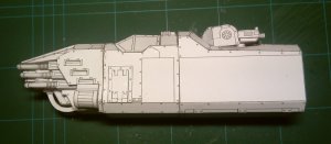

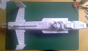

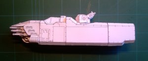

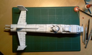

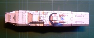

Main body finished
I have finished the main body. I did not have any problems with the last section or attaching the rear cannon section.
Main body finished!!!
Now on to the mail wings.

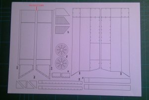

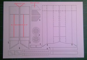

Wing mount/air intake
I have started on the wing mount/air intake component.
I decided to take a little creative licencing with this component to make it look a little more "realistic". Here is part of the instructions and the parts sheet to illustrate what I am talking about.
The section in the red box is what I am talking about.
Unfortunately, there is only a top and side view to the instructions.

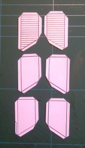

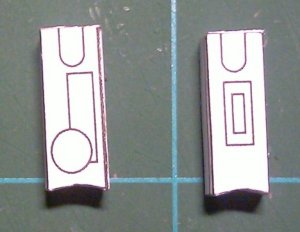

I added glue tabs to parts 57 (see photo above). If you notice that there is only one non-striped part 58*
Parts 58* are suppose to be placed far into parts 57 and 59 and really would not be seen very well. So I will be changing the positions of parts 58*.

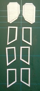

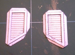

I have hand drawn (and added glue tabs to) parts 58* (with extra parts for internal support, because the original parts do not fit properly and I wanted to make it look a bit more realistic)
I have hand made frames that will go on the outside edge of parts 58* (striped panels).
Parts 58* finished and ready to be mounted.

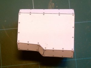

Here are more photos of the wing mounts/air intakes.

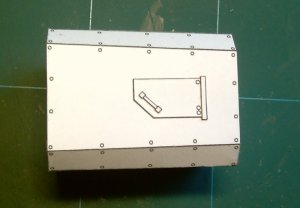

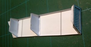

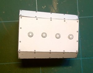

Here I have placed the new part 58* (striped panel with frame( at the front of part 57 (as well as the interior support and the non-striped panel where I feel they need to go.)

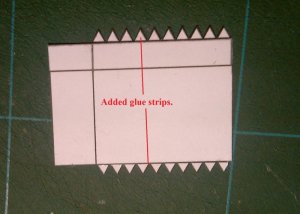

I added glue strips to parts 59.
I attached part 59 to the rest of the assembly.
As you can see there is a slight over hang at the bottom edge. I found that i did not need the bottom glue strip, and removed it.
Leave the lower over hang from part 59. It will attach to the main body with out any problems.

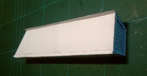

Back side of the wing mount/air intake
Front side of the wing mount/air intake
Wing mount/air intake attached to the main body.
