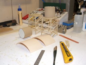

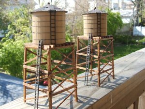

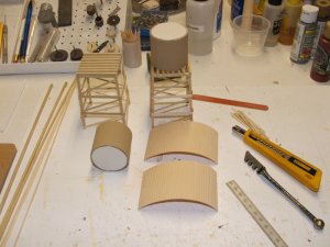

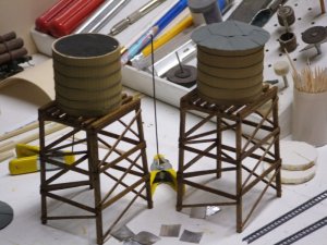

Been busy with a lot of construction work which is good but not much time for trains. Here are some pics of my water towers that will be part of the mill project. I will probably build 1 or 2 more, maybe a little bigger. Paper towel roll wrapped with scored bass wood. Bands made from wire stretched around tank. Framing poplar stained with Early American Min Wax. Tanks painted with Folk Art brand Barnwood acrylics & washed with Indian ink /alcohol. Thanks for viewing & all comments are welcomed.

Nice tanks
Those are nice tanks, a feature many folks forget to add to a mill structure.

One question, how did you do the joint on the tater tower bands? how did that go? and if it worked well, can you post a detail photo?

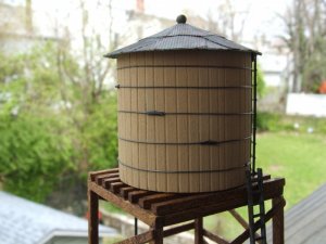

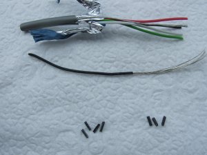

Tank Wire Bands

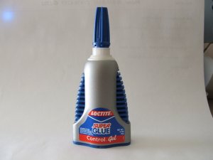

Hey Bill glad to hear from ya. This Forum has been kinda quiet lately. On the wire bands, they went well but I think my tanks might have shrunk a bit, the wires are a little loose. I don't know where this wire came from, it has a corroded metal look to it is why I used it & I already had it lieing around. I spaced the wire location out close to equally & drilled a hole where I wanted a joint to be. I pushed one end of the wire through & bent it back so it would stay tight when pulled. I wrapped the other end around & did the same while pulling it tight & put a drop of epoxy on the inside of the tank to keep the ends from comeing back out. On the fastener this was a first but worked real well. I took a piece of phone wire(the black one)& pulled the wire out leaving the insulation. I then cut the insulation into small pieces & sliced them in half length wise leaving me with 2 pieces each.This was a half round cover that wrapped around the wire joint & looked like a fastener.I used a very small drop of a fantastic super glue by Loctite a control gel. I am very pleased with this glue,tip stays clean & does not harden, good aplicator & it's a gel. any questions give me a holler. PS Check out my Amish Barn Raising on the Scratchin & Bashin Thread.

good idea with the bands.
I spaced the wire location out close to equally & drilled a hole where I wanted a joint to be. I pushed one end of the wire through & bent it back so it would stay tight when pulled. I wrapped the other end around & did the same while pulling it tight & put a drop of epoxy on the inside of the tank to keep the ends from comeing back out. used a very small drop of a fantastic super glue by Loctite a control gel. I am very pleased with this glue,tip stays clean & does not harden, good aplicator & it's a gel. any questions give me a holler. PS Check out my Amish Barn Raising on the Scratchin & Bashin Thread.[/quote]
That loctite gel is good stuff, I used a lot of it on the surry parkers (your unique logging equipment, in the logging /minning area). I just bought another bottle of the stuff, as my last hardened up, the aplicator has the best controll in acc I've ever messed with.
I like the idea if drilling a hole to ancor the bands, I have a 30 year old scratchbuilt tank, whose bands have mostly fallen off, I'll try this method on the replacements, and see how long they last.
Thanks for the idea, sounds good
