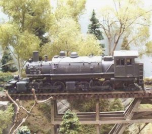

What a beauty! (said with Jon's famous imitation Aussi accent)
Nicely done, Ian! :cool: Looooove those Mallets. Nice lookin' bridge approach in the background. Do you have any logging scenes on your layout? Is it free lanced or do you following the West Side Lumber prototype?

Hi Stan,
My layout is not really photogenic at the moment with only trackwork being done , most of the hardshell as been done but thats about it .
I have get a little distracted detailing some locos and rolling stock , i seem to put my limited time into those these days.
As for following the WSLC , not really , i am not too fussy about prototype , i don't know if WSLC had much standard guage let alone a articulataed logger , i just like the look of it.rolleyes:
Thanks for your thoughts:

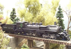

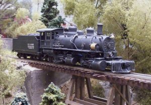

I hope ya'll will forgive me for resurrecting an old thread. I've only recently learned of The Guage.
I bought this old Mantua logger from a fella online for $5. I replaced the boiler, cab, and walkways by getting replacement parts from Mantua. Scratchbuilt the monkey-deck out of styrene sheet and styrene square tubing, and the plow was a Presicion Scale brass piece.
The walking surfaces on the Monkey deck and "running boards" along the boiler were covered by brass diamond-plate.
I figure I've got ~$60 in extra parts tucked into it (including a new NWSL can motor).
I'm going to be posting newer pictures very shortly (if I can stop the online gaming long enough). Everything is complete except the final paint on the boiler.
This engine now runs quiet and smooth, and has reversible lighting. I've left the tanks in place, but have converted the cab to the tender-engine style and am running an MDC short Vanderbuilt tender behind it. I'm trying to model it like the short period of time when the Sumpter Valley converted these from tank to tender. this leaves me room to pack a lot of extra weight on it.
Oh, and I lucked out finding the spoked lead and trailing trucks. Precision Scale seems to sell out of these on a regular basis.
