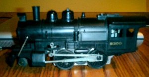

OK, here's my poor wounded baby.
The marking on the side is 8300.
As I've already said, it's a 2-4-0 and it has a pullmor motor.
That's all I really know about it.
The top drive rod on the right side broke down by the back wheel.

If you can disassemble the side with the "good" rod, you can use it as a pattern for making a replacement for the broken one. I would use brass, as it's easy to work with, but if you want "shiny", check at your LHS. Whatever material you choose, use something the same thickness as the original. Use a scriber to trace the shape onto the material, then centre-punch and drill the holes. You can cut out the rough shape with a hacksaw or jeweller's saw, then file to the final shape. Careful use of a cut-off disc in a Dremel tool will also work for this step.

I could try brass.
I could get 'em to match thickness wise but they will definatley look different as these were molded and go from sort of squarish to round.
I have also noticed that a lot of the later trainset Lionels only had one driving rod. I could take the top driving rod off the other side, put in small spacers on the bushings and run it that way. I'm not sure if it would look quite right to me though.
