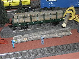

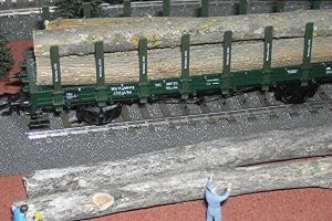

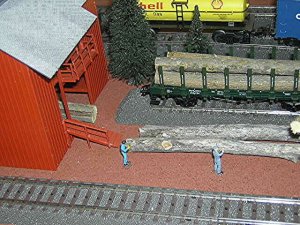

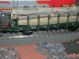

Pics of Logs at the Equity Junction Mill
Shown here is my version of HO logs made of trimmings from a Silk Tree. All natural. Bob
