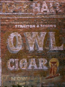

That is a wonderful building! Stunning, even.
I have a few ideas for signs on my buildings, and I have no idea how to get them to look faded and what not, but right now I am trying to scratch build some abuntments for 3 bridges on my layout.
Here is one pic I found that I would love to put on a building.
Spray on concrete... huh.. I would have done it the hard way... mixed up some plaster o' paris and slapped it on. I'm not the smartest blade in the tool box...

Your idea for the faded sign is exactly the kind of thing I'm about to try!

For signs, you might find something in the way of dry transfers to use as a starting point, along with an airbrushed background and, perhaps, some home-cut stencils. Weathering could be accomplished with some judicious sanding, and either washes or oversprays of extremely well-thinned colours, including the original wall colour.
