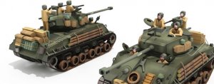

Those tubes came out excellent. I would have probably cheated and bent plastic around a metal armature. I have made paper tubes that way, as long as the radius is not too sharp, with water forming, and glue mixed in, it dries hard and you get a smoother surface. Your engine deserves to be seen, maybe you could make a diorama of guys putting the engine in. You could use the guys from Paper-Replia.com, you could scale them to the right size, if they aren't already.
Here's a link a pic to what I am writing about. Just a suggestion, I'd probably stick it in the tank to protect it. :)
Link = http://paper-replika.com/index.php?...4a3e8-tank-paper-model&catid=38&Itemid=207362

Zathros, thanks for the tip, but your later suggestion is wiser :)
Boris, if you look for completed ones, you'll see that a lot of t is seen pretty good. But i'll consider your and Zathros suggestion, though no promises :)
