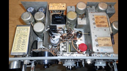

It's amazing that they would put a tube radio in the turret!! I have a collection old vintage tube amplifiers, (these suckers are quite valuable, and sound incredible), it's amazing that the sockets could take the pounding. The U.S.Army radios were built quite robust back then, but geez, I thought they would be mounted on something that would absorb the vibration. Looks fantastic though. :)
The insides of these were pretty much the same, some didn't have the side battery pack you model shows. You can see how each tube is covered with a metal cover, the sockets probably float each and that takes all the shock. Modern radios have to be mounted quite differently, they are more delicate. The dial with the flat plates is a variable capacitor, that's how you would try and find the signal. Lots of "know how" needed to use one of these properly :
Missing Battery of left hand side

Tube amps are awesome. Audio Tube amps have around a 1% THD (Total Harmonic Distortion), which, compared to modern electronics which are at around .001% seems ridiculous, but they have far less total "non harmonic distortion" than modern electronics, which is why quality tube amps just sound better than transistor audio systems. New algorithms had to be designed to measure the non harmonic distortion, thus the return of Tube Amplifiers to the audio scene, and at exorbitant Audiophile prices.
Just before transistors came into being, a new type of tube had been developed, they were around 1" tall and a half in wide. They were rendered obsolete by transistors. These tubes would have been immune to electro-magnetic pulse (EMP) that would leave modern devices dead. However, you would have to wear a pacemaker for your heart on your back in a back pack. ;)
