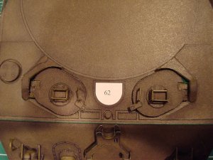

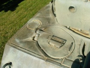

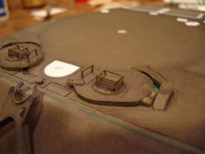

I just finished the crew hatches. The instructions were very poor, so I found a picture that shows the detail for the hatches. (first picture)
I used Evergreen plastic to create the grabhandles and other details. (second picture)
I chickened out and glued the hatches in the closed position. My skills are just not that good; at least not yet.
The rest of the pictures are self-explanatory.

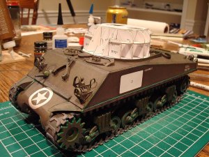

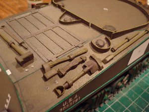

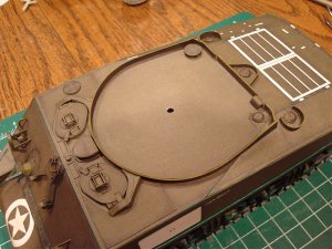

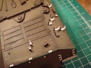

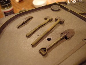

The next step in building the Sherman was to glue the ring around the turret. I am not sure what this is for.
I added the pieces that cover the engine.
I spent a little extra time on the shovel, axe, and other various tool items. These turned out better than I expected. The real wood for the handles adds to the realism.
I am hoping to get started on the turret yet this weekend, but my wife is starting to give me the "stinkeye", so I will have to see....
Please feel free to point out mistakes (I have learned a lot from honest feedback).
Enjoy!
Ken

charliec
Jan 19, 2004
388
74
Brisbane, Australia
Ken
It's the bullet deflector ring. The turret rotation ring with its rollers can be jammed by bullets or fragments - this ring is designed to deflect these. It doesn't happen as easily on modern tanks because the turret rotation ring is recessed into the hull.

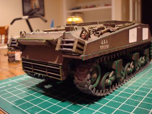

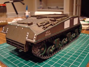

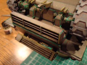

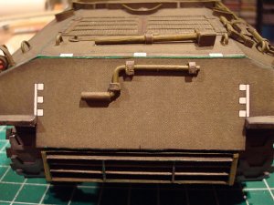

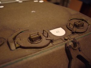

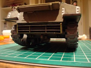

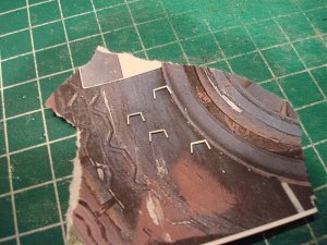

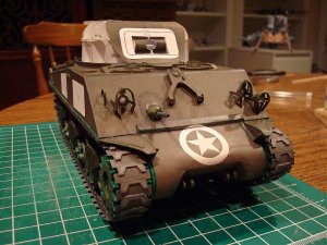

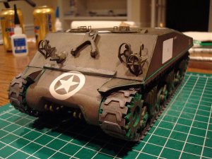

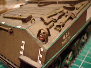

I made a little progress on the Sherman.
Picture 1 shows the rear light assemblies and the metal guards.
Picture 2 is some kind of a tool. The instructions were were unclear about this as well - no illustrations.
Picture 3 is a fold down tray. It hides the tool in picture 2...
Pictures 4 and 5 show some kind of a roller assembly that mounts under the fold down tray. I am embarrassed by how much I don't know about the subject I am building.
Picture 6 shows the extra track racks in the back - also note that in picture 6, I tried to change the edge color again - this time to Testors Medium Green. Still not exact, but very close under normal light.
Ken

Your edge coloring is worlds better. It's like the parts are precut by the printer. Nice going. I think it won't be hard to go back and touch up areas that are bright green. It seems those are more prominent and easily accessible.
charliec
Jan 19, 2004
388
74
Brisbane, Australia
Ken
Pic 2 looks like the crank handle to manually start the engine. Engines back then weren't high compression so they could be turned over with a crank handle - probably wouldn't have been easy to do though. There is a video of the King Tiger at Saumur being crank started at YouTube - "The Roar of the Tiger" Maybach Engine ã‚­ãƒ³ã‚°ã‚¿ã‚¤ã‚¬ãƒ¼é‡æˆ¦è»Š エンジン始動.
The rods under the fold down tray look like the gun cleaning rods. These screwed together to make a long rod that a cleaning sponge/brush could be attached to.
Regards,
Charlie

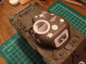

exzealot
Jul 3, 2007
142
65
Lake Orion, MI

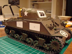

Here are some pictures of the turret build. This was difficult! I have to admit that the model designers were very precise in the design. The tick marks (front and back) must be lined up PERFECTLY in order that the edges all line up properly. Happily, I lined mine up fairly well, and the edges came out acceptable (to me anyway). The vertical edges will surely give away the fact that this is a paper model. I have seen some of the ship builders here on Zealot sand and fill hulls - which is what this turret requires. But since I am colorblind, and having a difficult time with the edge coloring as it is, I decided to leave well enough alone. Once I ornamentize the turret, the lines will tend to move to the background and not be so "in your face".
Ken

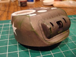

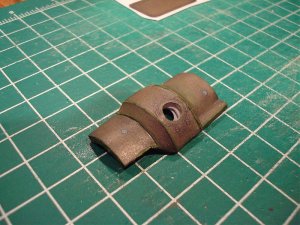

exzealot
Jul 3, 2007
142
65
Lake Orion, MI

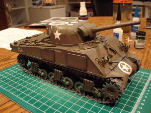

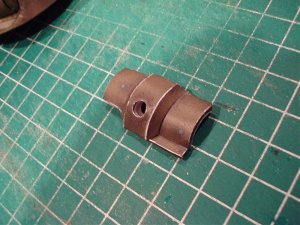

Here are some shots of the gun build. The piece that fits between the turret and the gun was a very difficult part to make without warping (pictures 2 and 3). I had to perform a little surgury on the mess I made to make it come out as good as it did. The shroud that glues to the turret itself was fairly easy and straight forward (first picture).
Also, note that I added the panels on the sides. I left them off until now so that I could handle the model a little easier.
It won't be long and this project will be complete....
Ken

charliec
Jan 19, 2004
388
74
Brisbane, Australia
It's called the mantlet - protects the working parts of the gun .
It's often easier to scan and print the gun barrel on 80 gsm (20 lb?) copy paper - it's difficult to roll up a gun barrel from card stock. Alternatively wetting the card with methylated spirit (denatured alcohol) makes cardstock it much easier to roll - although some inkjet inks will dissolve in alcohol.
Regards,
Charlie
