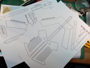

Well, i decided that i'll try the hardening with the grip and the receiver, starting with the grip. Let's build, experiment and see what we learn from here.
