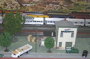

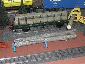

Glen, I like your lumber stacks, they look very real. Nice job. A few years ago I found lumber stacks in the Walthers catalog and put those in my display on flat cars and trucks. They look more like the finished lumber I see daily rolling down I-5 here in Norcal, some from Canada. But, I really like logs as that's more to my heritage. Here's a couple of examples from my layout. Bob
