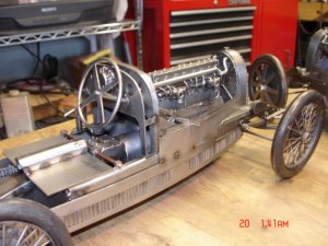

I did cut up some metal for the RR AC and took some photos of it. The Brough Alpine and the Harley with Sidecar were shipped off to a gallery and the Morgan Trike was sent to a Morgan collector. I didn't think it would bother me to get rid of them but it did and it bothered my wife to see the Brough leave.
Talk to you later.

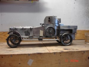

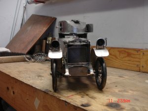

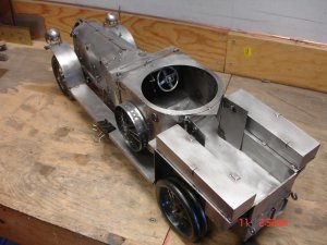

I finaly finished the RR AC impression, no more large, it's 25" long, complex projects for me. Unless there's money involved.
Jim

I think you could get a small fortune for this if you tried to sell it It's fantastic! :)
