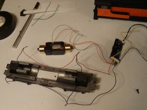

UP SD40-2 No problem:mrgreen: . check them out, post what you have found, once i know what you have to work with, i'll know how to advise you on getting sound in it
Well In guess I'm older than I wanna be looks like it isn't dcc ready.
I know they were some of the first units made

slekjr, you could "hot-wire" the Loksound decoder in:winki: . after looking at your pic, i don't see the black wire:confused: , if there IS a black wire connected to the circuit board, hotwiring the sound decoder in will be quite easy:thumb: , if i AM seeing right, and there is NO black wire connected to the circuit board, that tells me that the motor is grounded to the frame:frowns: . what you would have to do in that case is isolate the motor from touching ANY metal on the frame:winki: .
i have a Decoder/Sound Decoder install thread that will help if the motor IS touching the frame:winki: . look at the install done by Dan Raitz, you would install the sound decoder MUCH in the same way he shows the decoder install:thumb: . he uses a chipboard, you will connect the wires, and set yours up the same way, only your Loksound decoder will not be a chipboard. you can find the tutorial here: http://forum.zealot.com/t116552/
the wire setup for your(any) decoder/sound decoder is like this:
orange wire = right side of motor
yellow wire = backup light
black wire = left side of trucks
gray wire = left side of motor
white wire = headlight
blue wire = common wire for BOTH, the headlight and tail light:winki:
red wire = right side of trucks
i hope this helps:winki: . :deano: -Deano

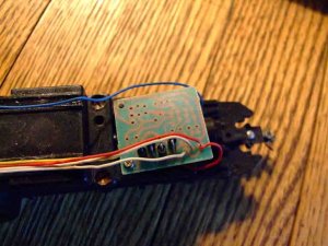

when it comes time for you do take on the install, if you have ANY questions, DON'T hesitate to ask for help:winki:. i have another sound decoder install tutorial to add to the thread i gave you the link to, this tutorial would be of GREAT HELP on isolating the motor:winki: . i converted my Walther's FM H10-44 to DCC:mrgreen: .....NOT FUN:frowns: , but do-able:thumb: . i have all the pictures done, now i just have to find the time to write it up:119: . (you can see the engine in THIS WEEKS Photo Fun thread, page 1:winki: , though i am not finished detailing it:119: ) .
:deano: -Deano
