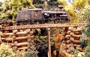

I would agree with my logging buddy Bill Nelson the Rivarossi Heislers are probably one of the strongest pulling model geared locomotives out there. I have two of the "new" release models, one three and one two truck. THese are very reliable, look pretty good and are the "go to" engines for operating sessions as they run great.
Here is a picture of the three trucker pulling the high line bridge.
Doc Tom

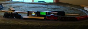

I did some more testing. Pushing is a little better then pulling, but only in the amount of spin of the wheels, not more cars.
Here is my test picture. 2.8 percent grade, four cars, two truck heisler. It pulled with only a little spin of the wheels. With five cars, it almost could not make the grade. A lot of spinning.

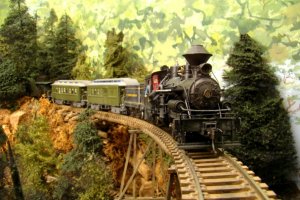

Hi Kent,
That is a neat test track. I am glad I kept my mainline to 2% grade as the two truck Heisler here can easily pull a 6-8 car log train.
Doc Tom:thumb:

Is that a Rivarossi? I see that you have added some chain to the front and back. Did you do anything else that increased the weight?
Kent
Kent
Hi Kent,
Yes, that is one of "the new Heislers" by Rivarossi just like yours. I had this prototype picture of a really decrepit Heisler that I just had to model. The result is in the posted pic. No extra weight added and the mechanism is straight out of the box.
The logging chains and the extended coal tender really add very little extra weight. Like my colleague Bill Nelson I have never been in the innards of this model and have been impressed at its reliabiltiy and pulling power.
The mainline including the cribbed bridge in the picture is at a 2% grade.
I wish I had had that neat digital incline/level you pictured when I built the mainline it would have made the work so much easier.
Sounds like you are going to have a nice RR.:thumb: Looking forward to some more pictures.:mrgreen:

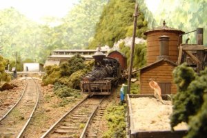

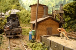

Sand those rails
This is an interesting thread. Looks like adding weight to the engine is the way to go. Or perhaps stop in at RAILCAMP and get a load of that HO sand to put in the sand dome. Those Rivarossi Heislers are so nicely detailed that the sand pipes probably do work well.
Doc Tom:cool::cool::cool::cool:
