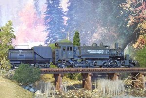

What I found with the Mantua 2-6-6-2, was:
It needed a can motor.
It needed universal drive couplings, vice the flex tube.
It got metal wheels in the pilot, and trailing trucks (for increased electrical pickup......mine was a tank type loco)
Mine finally got a tender added, but haven't wired it in yet. When that is done, I should have no problems with electrical. The cab, and saddle tank are from MDC, the tender is also an MDC kit.

Bill,
mine has a can motor, flywheels, and universals out of the box.
When Model Power bought Mantua, they said they were going to make some improvements, sounds like they tried.
Doc Tom,
That is a really nice picture. Beautiful engine!!!!
Thanks! It was a fun conversion, runs well, and yes it does look good!:mrgreen:
On the older 2-6-6-2s, electrical pickup was, if I remember correctly, right side drivers on the lead engine, and left side drivers on the main engine. I added right side pilot wheel, and left side trailing wheel, and it presently runs with those, "basically axle to frame" pickups.
