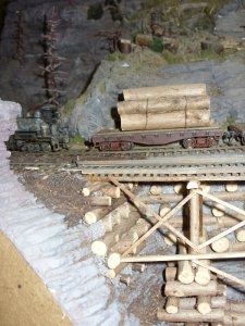

I have taken some photo's of the lower hill holders @ Terrapin Tn.
In the first photo you can see a log car held by on the inside track , at the lower side of the Terrapin Tn. passing siding. The Brake is on on the inside track, as well, so you can see the wire sticking up just enough to catch an axle.

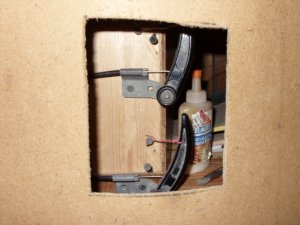

the second photo shows the controls. sheet rock screws limit the up travel, and wires ,run through a hole drilled in the handle, limit the downside travel- so the wire doesn't go below flush with the ballast.
These devises, made out of Volkswagen Golf hood release cables, hold cars in three locations on this passing siding on an an 8.5% grade, allowing switching to be done for the log camp @ Terrapin, and the Water powered sawmill further upgrade @ Perry's Gizzard layout photos @ Eastern Tn logging on the DG CC & W RR 1928
