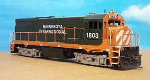

Jorge,
I'm not that familar with the Lionel U18B. Trying to find one these days is not easy.
There was an excellent artricle in one of the first issues of "Diesel Era" (Sept/Oct 1990). You could compare the Lionel unit with the photos in this article.
As for me I made my U18B's from an Athearn U30B.

Lionel’s U18B shell is fine for the door detail and such. It suffers from the same problem as the early Athearn shells, too wide by a couple of scale feet. I have some, and they have EMD Blomberg trucks instead of the AAR Type B. I would say it runs as well or better than the Athearn from the same time period. I used mine as a switch engine switching a friend’s yard. I could really kick those cars, because it had no fly wheel. Even without the flywheel, it is a smooth runner and could run slow. It beat an Athearn U33c in tug o war contest. I got lucky when I picked mine up, haven't seen any since then.
I really like your model Jorge. Very well done and an interesting paint scheme.
Greg
