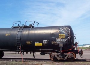

I found one similar to that near me!!! Here is mine.

That tank car in seanm's post looks brand new. Almost right out of the builder's shop.
Could you imagine standing there when it collapsed. What kind of noise does that make?

seanm
Oct 11, 2004
358
Sunny CA
www.pegnsean.net
Frankly I was shocked to see that tanker when I got the shot. I sort of blinked a few times and thought.... Wow! Not even a paint chip on it and it done for!
Too bad about the horizon. I guess I could rotate it a buit and crop.
