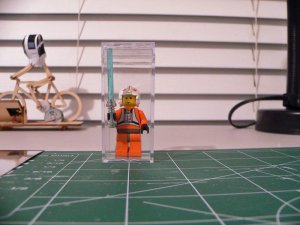

Ordered a Lego Luke pilot - got one but it came with a gray light saber handle – so I ordered a chrome light saber handle. Yes the postage was more than the little piece – but it matches the model now – it is not in mint condition so it’s not for collecting – just wanted one to compliment the model. (OK truth time - got it to have at least something if the model does not work out...;))
According to the designer, this is the first version of Luke that LEGO made (1999).

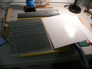

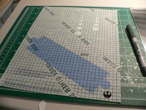

Finally found some silver/mirror card stock, it is 12” x 12” so had to cut it down to 8.5 x 11 to fit in the printer. It is kind of thick so I thought for sure it would not feed or jam – but it worked fine.

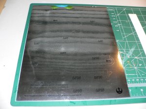

Unfortunately, the ink even after several hours of drying just wipes off – it won’t stick. I suppose I can still try to cut it out without wiping the ink off. If that does not work I could print on regular paper and place it on top and cut it like that – the ink on these parts are for cut/fold lines only – no color or art work.
Any suggestions from the masters out there would be appreciated!
Another issue may be gluing this stuff to itself – it is glossy and in trying to glue some scraps I noticed it does not bond well. May need to score the gluing surfaces with the X-Acto to help adhesion.
Update: Found that if you cut the "mirror" layer off to the bare paper it works. (Made a new sword handle cover for the Fencer model.) This will be tough on the smaller parts. The "mirror" finish does not crack when it is folded.

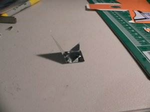

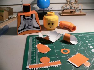

Found some “window decal” transparency paper – but, while it is clear – one side is sticky – it is not a static cling type of decal. Seems to have printed well but it will be interesting to assemble since one entire side is sticky – the saber is a tube so it might even help. If it does not work, I’ll have to buy the real thing.
Here is the first attempt. The sticky backside picked up smudges and finger prints and made them plainly visible. The adhesive on the backside was not strong enough to keep the top and bottom caps flat so here I am experimenting with regular Elmer's Glue. I'm not liking the look, so I may end up trying real inkjet transparency paper or colored transparency paper. Would really hate to give in and use printed paper.
The saber is looking to be the most difficult part due to the materials.

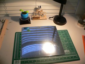

Also got some "aluminum" inkjet paper to try as an alternative to the really thick card stock.
It is very thin and has a shiny metal finish on both sides. It cuts and folds ok, but now the problem is if it can be glued to itself. Here is an experimental piece with Elmer's glue - we'll see if it holds well enough in the morning. I really don't think its thick enough.

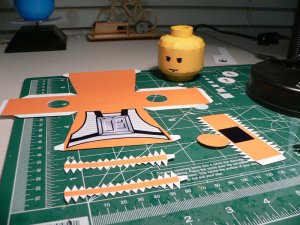

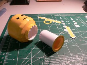

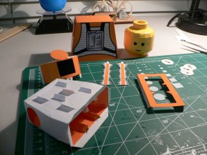

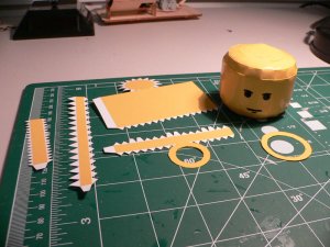

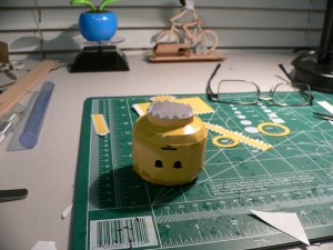

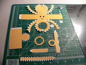

Here we have the parts for the head and at various stages of assembly.
Again, this all about having fun...
Back to assembly...

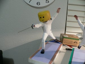

Haha! The fun pics are funny indeed, especially the fencing and the cycling!

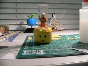

That was one of those - "oh I've gotta take a picture of that!" - the flip flap plant was icing on the cake.
Uyraell, thank you for your kind remarks. I cut the slits with a knife before cutting the parts out so there is more support to prevent tearing. Also found that cutting the slits a little longer on both sides and using the knife blade to widen the slit - by wiggling it back and forth made it easier to assemble - oh, and not too much glue (if any) on the tips of the alignment tabs as they will get "damp" and bend easily - which makes getting them in the slit quickly before the glue drys on the other tabs a little nerve racking - also my hands tend to shake which only makes assembly all that more fun :mad:. Make sure to push down on the part firmly till dry so it does not "puff" up - that is lift up on just the tips of the tabs. As for alignment, eye-ball it and move the part so it is in the center of the part you are attaching it to. As you see can below, even with the alignment a little off, the paper will probably give just enough to make the illusion believable.
I'm not familiar with the paper you mention, but the type I use does occasionally "split" at the edges if there is a fold near a small part - just have to add glue between the split too. Pre-rolling a carved part using a smaller diameter pencil helps keep the tension off when drying. Below are some pics which may be overkill - my apologies if you don't need this. (I learned it here)...
