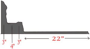

I did this quick elevation (side view) up??
Is the 4" width...wide enough for a track and roadbed?

Well to tell you the truth I keep forgetting your working in N scale so 4" width should be more than enough. Are you going to make up your own roadbed or purchase it new? :wave:

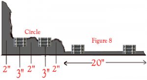

actually my bad :eek:ops: on that quick elevation I did up..
should be like this

To clarify:
the 3" spaces are for the ONE (upper) track...oval or circle...simple
which will be my second train set.
My main track below will below which will take most of my table up
strictly on ground level.

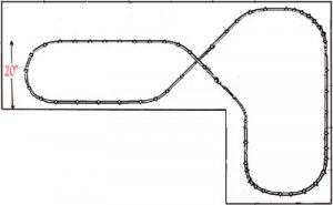

something like this.....
All I am worried about is the TURNS (radius) on both!!!!!!!

Drawings are good! Now we're getting somewhere. I would suggest two things: (1) the tight 180 degree turn on the left is too tight, and (2) try to avoid running the track exactly along the edge of the table, or parallel with it. It makes the layout look like a kid's roundy-roundy oval. Any kind of slight angle and gentle curve will improve it no end...

'still' UNSURE about the radius thing... do you measure that from the mid-track to the other mid-track at the bend?
