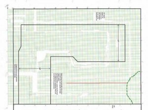

Heres a Quick Idea I threw together for Benchwork for a walkaround layout in a 12 x 12 room.
It can be built in modules, makes access easy.It is for an out and back design with the ability to provide for continuous running on the 4' wide penninsula.The penninsula has provision to use a wide radius curve yet It gives 36-42" wide aisles and the feel of a long run with the divided 4' penninsula.The door could be anywhere along that 12' wall and considering its a 12 x 12 room,the only problem would be windows, closet doors etc.. The benchwork plan also provides space for a workbench.If a benchwork layout like this appeals to you, this gives several guys the opportunity to work on track plan idea's for you.
Copy the photo to your desktop and open it with a viewer that will allow enlargement.Modules can be made to whatever size works best for your situation.
18 x 60 maximum is easily transportable as is a 24 x 36 or 24 x 48. :)

The only advice I can give is be very careful not to start something that's going to take years to get to where it's usable. I've seen way too many folks go down this road. You know how much time you have for the hobby (it always seems to be less than we think), and how much progress you can make in benchwork, track, wiring, etc., in any given "play" session. And don't forget a significant part of your (in my case at least) hobby time goes to thinkin' and plannin' and engineerin' and just plain dreamin'.
Model Railroader's track planning contest for an 8ft x 9ft room (many plans re-published in "48 Top-Notch Track Plans") had several good ideas that would fit much better in your 12ft x 12ft - aisles would become much more reasonable in particular. Ian Rice's book on small track plans (having a senior moment with the title) has some other ideas.
To run your Sumpter Valley 2-6-6-2 on any kind of continuous path requires 1 of 3 options:
1) an around-the-walls plan: Drawbacks are crossing windows, closet doors, and a duck-under, removable section, or swing away section at the entrance door. Ian Rice's "Linked Logger" is one way to minimize the problems crossing windows and doors by using removable cassettes on section of walls where you don't want to block access to the wall.
2) a peninusla plan 4.5 - 5 ft wide (maximum for good access) and 9 ft long, could have wings along some walls. Drawback is much shorter running room for your favorite loco. With careful placement and limiting the wall wings, you can eliminate the drawbacks of the around-the-walls.
3) if you combine around-the-walls with the peninsula, the peninusla length becomes very limited (8ft or less) due to required aisle space at the end of the peninsula. You still have all the drawbacks of the around-the-walls, but gain the most layout for the room size.
