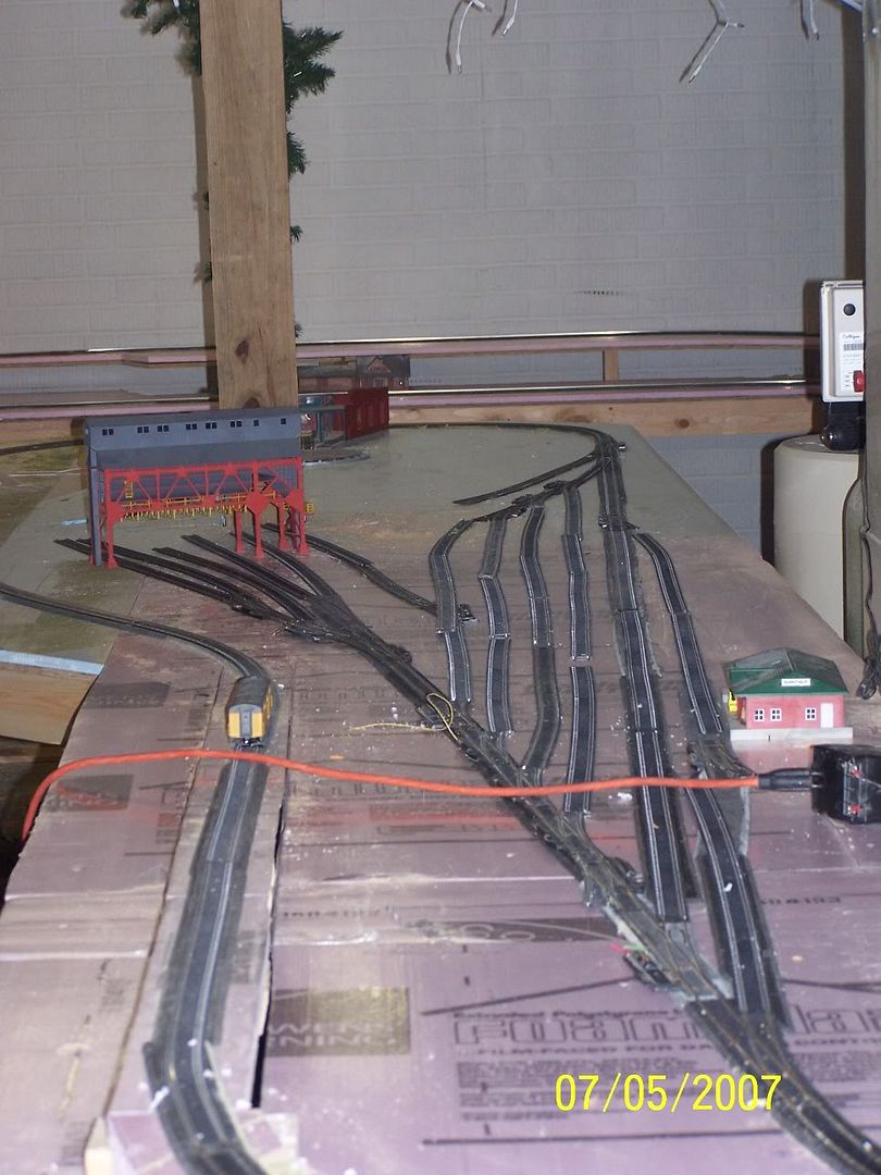

Here are some of the track layed
This one is to the lumber mill. There is a 4% grade to the middle track that uses a helper district, and a 6% grade to the top for the Shays.

and the yard area, it still needs some roadbed but you get the idea..

Does anyone see concerns on the 6% grade using Shays???

I think all the HO model Shays will go up a 6% grade just fine, but they will probably only pull 1-3 cars doing it (depends on cars and weight of Shay). Of the 3 non-brass HO Shays I know of (Bachmann, Roundhouse, Keystone), the Keystone will have the most pulling power, and the Bachmann probably has the least. Your results may vary widely.

My tboiler bachman On30 shay will haul 11 ounces up an 8 % grade. That's about 2 cars in On30 weight, which I ignore by the way. I use the NMRA's weight for HO for my cars. Anyhow, I loaded a gondola with pennies and then weighed it. That's how I know how much it can haul.
I hope that helps :)
