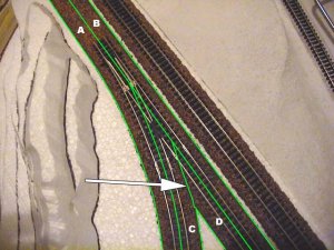

Rather than have you wait, I took a picture of an already completed area of a turnout for demonstration purposes. If my explanation is good enough for this picture, you can get busy - I will still take pictures of the process tomorrow or the day after, however.
(To make this easier to explain, I have labeled the 4 pieces of cork A, B, C, and D in the picture, and outlined them in green.)
Here's what I do:
You should have your track plan drawn out already, it makes this a lot easier. First I lay the easy complete sections (A and B).
Next, I take a strip of cork, and lay it along C. I let it overhang completely over the top of piece B. I tack it down with pins, then, along where it meets B, I cut it with an X-acto knife. Should have a nice pointy end. Glue it down.
After C is down, I take piece D and do the same thing - let it overhang completely over C and pin it down. Taking my X-acto knife, I cut piece C removing the beveled edge where piece D covers it (the big white arrow). When that is removed, I then cut piece D along where it meets piece C and glue it down.
If you follow these steps, its pretty easy and you can cork your entire layout fairly quickly. The trick is to have LOTS of pins handy. I bought two packs of 100 and found that is not enough! :D :D
