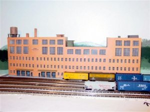

I found another source of materials while cleaning out an office file the other day. We used "invitation" sized cards to send out new product announcements. the company logo changed so these cards were no longer needed. They became the materials for the Matthyro Freight Terminal that will be one of several backdrop buildiings behind my yard. Here is the card stock.

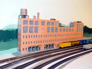

and here is a rear view of the construction project. There are 118 windows in the building. I used the fiber glass drywall tape for the pane dividers and pieces of the plastic covering for a bulk pack of ink-jet printer ink for the "glass. The structure is about 18.25" x 5.5" x 1.25". The covering is a "brick" paper made from the pattern that TomPM sent several months ago.

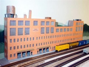

and here is the structure. I still need to add the doors but I wanted to put it on the layout because I am expecting the "Gauge" car any day now.

The yard piece is about 8' long but I only left about 1 1/2" between the last track and the wall which was not too smart. It rather limits what can go in there. And I didn't want to use one of the background posters. I think that I will put 2 more smaller units in there for effect. I am watching the Walthers (THS) mailers and the MR ads for ideas. I am naming these structures for the "cardboard" builders here on the Gauge.
