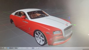

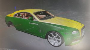

I work as a 2-tone masker at Rolls-Royce Motor Cars.
After hearing about my "little" hobby, my manager has asked me if I would be willing/able to build a large model of one of the cars. I said I would like to give it a go as this is something I have been thinking about myself.

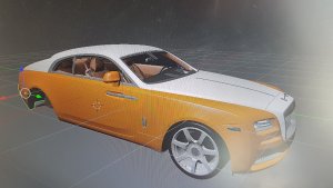

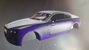

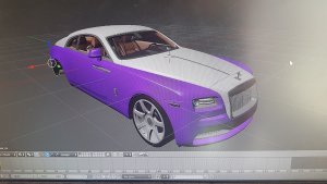

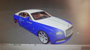

To cut a long story short, we got the 3d model transferred to my pc and simplified to a standard that I could work with.
We also decided on a 2-tone car in Arctic White and Twilight Purple.
So far I have arranged parts for the bonnet and front bumper. I have also started a rough test build of the bonnet.
The final model will be just over 1.1 metres in length.
More to come soon. :)

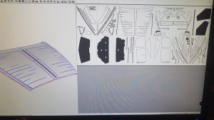

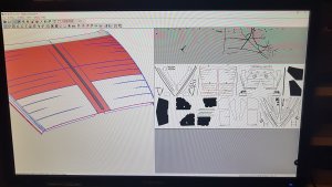

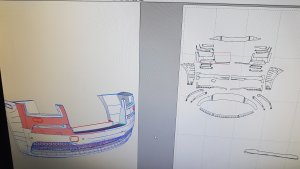

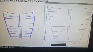

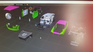

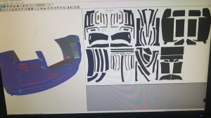

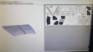

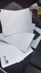

I separated the parts into individual files for export, then loaded the bonnet into pepakura to begin arranging the template layout.
The last picture is a semi-final layout after rearranging.

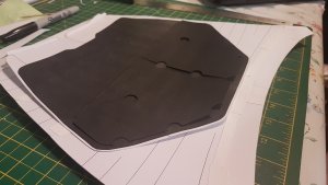

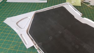

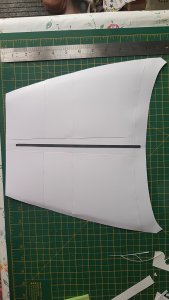

Next comes the test build of the bonnet to see if / how it would all fit together.
Please bear in mind that this is a test and the final model will be of better quality. ;)
I have got a little further with this but it's not quite finished. Also I have integrated another part to raise the heat shielding (the big black bit) on the underside to give it more relief.

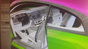

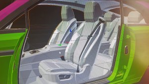

Also while I'm here, the texturing inside...
Not sure how many of the switches will be buildable but I'm going to give them a go. ;)

A lot of those switches can be made by lightly punching the back of the paper with a toothpick filed down (or other rod shaped tool) the diameter you need, against a firm but hard surface, like your cutting board. This will raise the button on the front panel, and give you the desired texture. You can do this with thin normal printer paper, then when done, glue that sheet onto the actual dash, and you will have your textured dash. You'll have to try a few methods to get the feel for it, but it works, and for many other features too. :)
