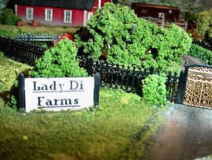

Hi Jim!
Well, as usual, you've caused me to have to get down on the floor, & pick up my jaw, & eyeballs! :D:eek: :cool: :D
Fantastic modeling!

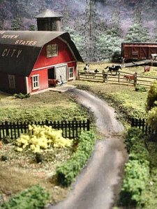

That's the best looking dirt road I've ever seen!
How'd you DO that?!
:cool: :cool: :cool: :cool:

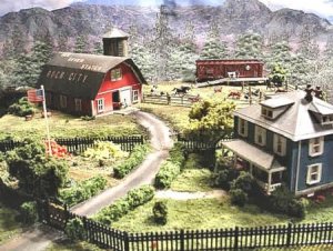

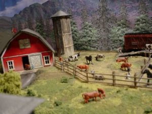

:eek: :eek: WOW :eek: :eek:
Very VERY nice!! Man everything looks SO REAL!!
What scale IS it? Is it a diorama or part of a layout? I didn't see any layout pics on your webpages so I was wondering. Are the mountains in the background sceniked or a backdrop? Purchased or painted backdrop?
So does dedicating the farm to your wife really get you off the hook for spending so much time working on it??:D teehee (sorry couldn't resist)

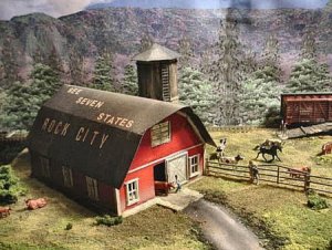

Looks great!
Jim that is amazing work. Love the barn! And that dirt road - WOW - it looks totally real! Did you use any plans for the barn or did you make them up yourself? I ask because I'm hoping to have a little farm scene on my layout one of these days - yep, this urban girl is broadening* her horizons!

answers to some questions
