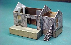

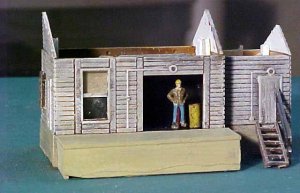

Well, Don got me thinking, & I've made a few changes...
First I chucked the kit roof, supports, & "knee walls"...
I found some Evergreen siding that was a pretty close match, & made peaks for a gabled roof...
I also shortened the concrete dock, added some steps, & cut up bits of a usedcoffee filter to represent window shades...

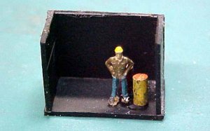

I also made a little chadow box out of styrene, painted the inside black, & added a figure, & some barrels...

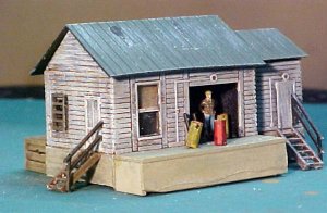

Got some roofing added, & a few more details...

Looking better and better each day!
One thing, if I may: Looks like the railing on that second set of steps is on top of the door - I think you need to move it a smidge to the right.
The weathering on the roof looks awesome! Is that a little hand cart holding one of the barrels??? Great details! :)
Edit: I've been wondering what those lolli-pop shaped engravings were that appear over the doorways - just figured it out - DUH! Aren't those lights? Do you plan to put little bulbs through there?

Thanks Arl!
I still have some more plans for this one...& yeah, I'll try to get some type of lights on it...not sure if I'll be able to use working lights or not...

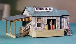

Well, I've done a little more today...Don gave me the idea for having an overhang on one side, so I cobbled together a sort of open shed on one end, with a "tarpaper" roof...Also Arl pointed out that the handrails were a little "off" on the front entrance, so I trimmed & tweaked those a little...
Oh, & you'll notice I've given it a name...Without giving away too much, I'll just say that I have plans for this to be one part of something a bit bigger than what you see here! :)

Fantastic Charlie. Glad to have woke up your thought process, but you have to take 100% of the credit for imagination.
I can't wait until I can get back to building structures. You are an inspiration.

Charlie: Great kitbash. Really turned out nice. That name is also fitting. Where in the heck is that Spitfire?

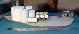

I'm in the process of piecing together a bulk oil facility, & I thought this little building would make a good office/supply shed type structure...here's what I've got so far...
