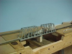

You are probably well aware of the Kato single, track, truss bridge; but I wanted a bridge that was more prototypical of the bridges that I have seen on the Union Pacific here in Oregon. Most (if not all) of the bridges that I have seen in this area utilize a shorter span, so what to do?
I saw in one of the N-scale magazines where another modeler was cutting down Kato bridges to make the UP bridges, so I decided to give it a try.
This is a Kato bridge before the operation began....

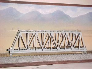

I took two Kato bridges and cut off the two end sections of each one and cemented them together. I was thus able to make two shorter bridge spans that looked more like the bridges that I wanted.
The bridge in the foreground of this picture is the result of my "cut and paste" operation.

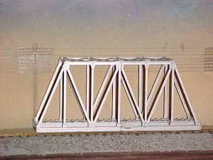

From the two center sections that were left after I removed the ends from the original bridge pieces, I did some additional cutting and pasting to get another bridge section that I hope to use as the start of another bridge.
On this section you can see the splice like I made to combine the original end sections. The center pieces also had to have some of the other supports removed to get the proper shape on the portion left.
