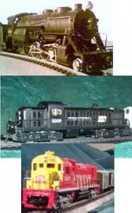

Just for fun and to see what's out there, how many cars can you pull with your best engines on your layout or oval?
My best two:
Bachmann plus series 2-8-0 Consolidation (I-10sa): 21 cars (before wheels slip)
AHM Alco RS3(? RS2?), 4-wheel drive (rear truck only): 20 cars (before wheels slip)
Tyco Alco Century, 4-wheel drive (frt. truck only): 20 cars (before slips)
I'm new to the hobby...these are my best so far....I know there are stronger ones than that out there...

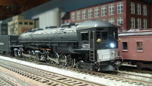

My Cab-forward does 25 NMRA weighted (1 oz. plus 1/2 oz. per inch in length) cars up a 1.75% grade on the club layout. I ran out of my own cars and I didn't figure it would count if I mixed in the unweighted club cars so next time I'll try all club cars.
