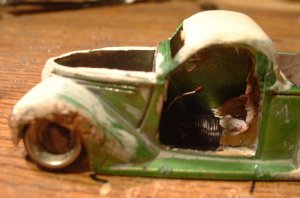

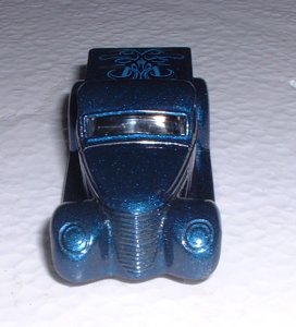

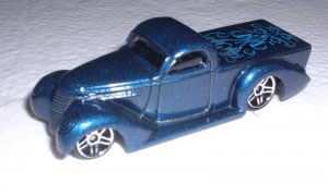

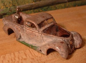

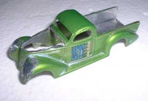

Here are a few pics of the progress of turning the "custom 40 ford truck into a hudson truck , which is what it looked like anyway
Here is the truck stock , a Hudson truck & the wreck progress.

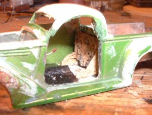

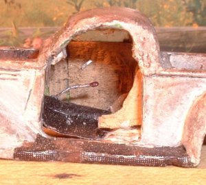

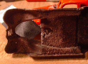

This is the interior , hope the tattered seat comes off OK.
OOPS wrong truck in the first picture .

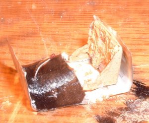

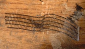

Andrew : I make the seat spring base out of a piece of some kind of elastic, here is a pic of it. I have no idea what it's called or where it came from, probably something from a fabric store, I prowl them every now & then they have a lot of very interesting things for a modeler. You just have to learn to ignore the funny looks the clerks give you as you ooooooooohh & ahhh over things! :eek:
Then I stick some cotton fibers in it from a Q tip,the upholstry is a Kleenex painted & installed wet so it will stick. The headliner is made of the same thing, I'll probably use Grosgrain ribbon for the door & kick panels.
The seat frame is the aluminum baking pan covered with Kleenex. One nice thing about building junk cars --they don't have to be perfect.
Before anyone asks, the rubber floor mat is the liner of a package of Basic cigarettes, other brands most likely use the same patterned foil tho. It makes great running board covers too.

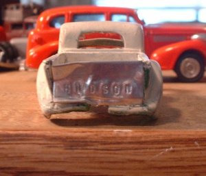

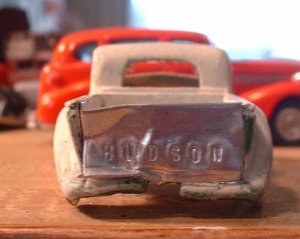

Take look at this -- think I'll have any problem passing this "custom 40 Ford off as a HUDSON now? Just wish that the 1/16 letter stamps had not cost 20 bucks!!:cry:
The 39 chev in the background will be next after the two Hudson pickups are done & the 40 ford coupe , I'm building bumpers for it now.

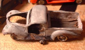

Here is how they look when they are used for running board covers. Also the 40 ford is progressing , hows this for a bumper --has to be rusted yet tho.
You sharp eyed guys will notice the Hudsons headlight is gone, I dropped it & it broke off & now my carpet dust mites are looking for a bulb to put in it so they can look for all the other parts I've dropped. Believe me I'm not fond of cutting another little gold bead in half!!

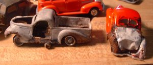

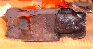

NUTS!!! A while back I posted about making mud & such using Plaster of Paris mixed with Powdered tempra Paint --- WELL, I spent ALL day trying to find some Powdered Tempra --- several places I called had it --so they said on the phone -- when I showed up all they had was liquid tempra. Tried to see about ordering it- every supplier has discontinued it .
So I am trying artists chaulks scraped into powder & mixed with POP ---- tell me how it looks to you?
The third pic is one done the old way -- when I had tempra.

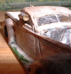

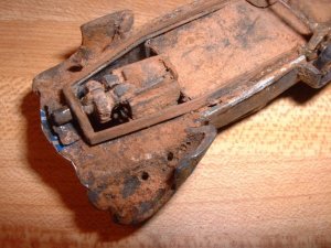

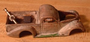

The Hudson is getting closer, here are a few pics of the "almost done" truck.
This is a shot showing the rear end I built for it & the radiator, rear end is a couple of electrical fittings( not sure what from) , half a gold bead & a reworked oval head screw. The radiator is a piece of the ribbed plastic from a CD case , with a brass "top tank" added.
Next is another view of the rear end & the w/s glass.
After that hopefully you can see the rest of the upholstry & last a close up of the gizmo on the passenger window --- anybody know what it is? I'll let you guess a while & see which OLD guy figures it out , you "youngins "probably won't. :cry:

The "gizmo" in the passenger window is an "swamp" cooler. They were popular in the desert before mechanical air conditioning became a popular option on new cars.
Where do I send the cigar? :thumb: I guess I copied it close enough if you recongized it!! I thought it would be a nice touch in the junkyard. Actually one would be quite a find , the hotrod guys are using them again , when they can find one. :mrgreen:
