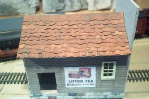

hehe ok so don't start calling me Dave Letterman yet.... today I was bored so I decided to try and make my buildings a little better by changing the roof... here is how I did it......
I started with black acrylic and texturizing medium....
I spread it thinly over a plain sheet of white bond paper...
I then sanded the back side of the paper to make it thinner (after the paint dried :D )
After that I cut the material into thin strips...
After I had the strips cut I wanted to make the shingles real to life so I cut notches in the strips...
I then pasted them with elmers glue onto the building.. a slow process...
I then drybrushed white to highlight wear and washed with black ink thinned with rubbing alcohol to bring out the individual shingles
the end product looks pretty cool :D

it was about a half hour cutting and laying 1 side. the actual prepping and making the "tar paper" was done earlier in the day... about 10 minutes total doing that part.
of course this was my first attempt and I am sure I can lower my time .... :)

I took the time to complete my shinglingand with the help of charlie I have "sided" it most of the way... I think it looks a bit better than it did before.. it has a bit left to be done before it is finished.... Sorry about the quality lost the cord to my digital cam... had to use the camcorder and grab some vid stills...
here is the side... I added the gutters too
and this is how it originally looked
the deck will be replaced (after the Faux Wood treatment) as well as the window scenes.... they will be improved...
