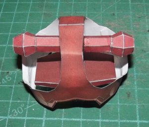

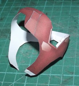

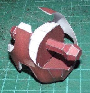

Front and back side of the hip / pelvis. Leave the lower half open to insert the pelvis center piece.

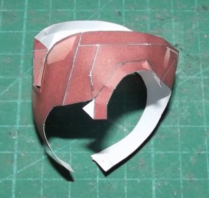

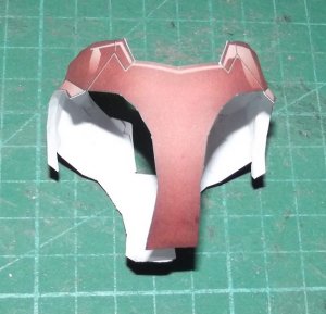

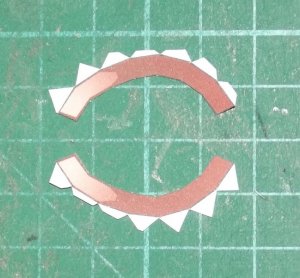

Mistake #2: Parts 9 & 10 are too long. Cut off the last segment.

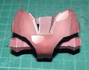

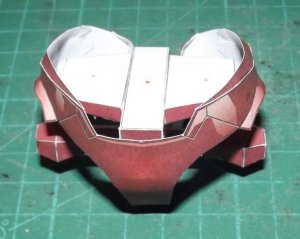

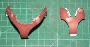

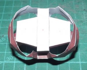

Glue the outer shell to the center piece.
