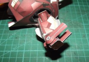

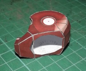

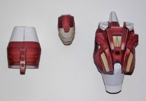

I started with the first section, head and torso.

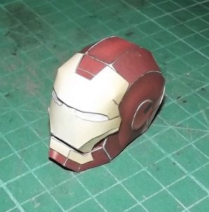

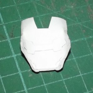

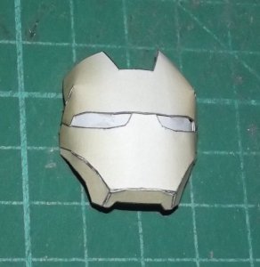

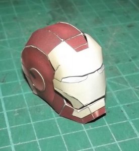

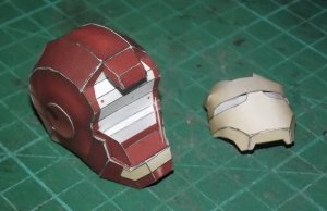

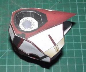

The instructions are very clear and the single parts are easy to identify. Section 1 is very easy and the result looks very convincing. This is the head. I'll have to make a new mask because the one in the pics had become victim to a drop of glue which accidentally sticked onto the visor. Due to the flash it is difficult to spot in the pics but it is there. And it looks kind of "meh".

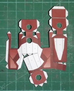

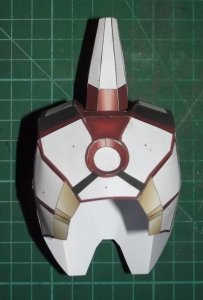

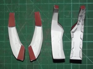

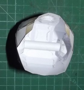

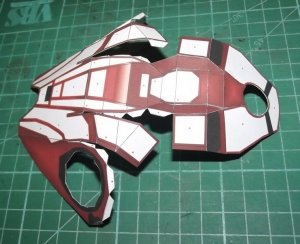

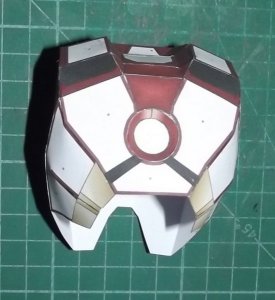

The main body. Many parts of the armour are laminated to it. Surely assembly would have been easier if everything had been printed right on the chassis, however, the laminations give the body more strength. In addition it enables you to increase the depth of some details. Before I attached the layers to the body I painted the edges with a brown felt-tip. I noticed that some parts don't have flaps. I made them myself if necessary. The overall fit is fairly good.

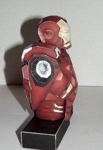

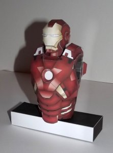

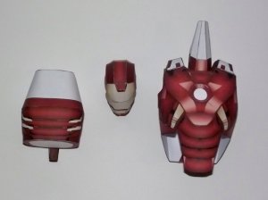

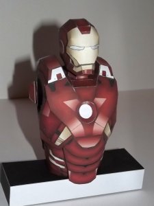

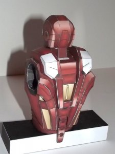

And this is stage 1 completed. CU with part 2, the arms. Stay tuned! :wave:

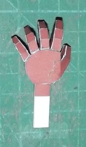

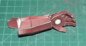

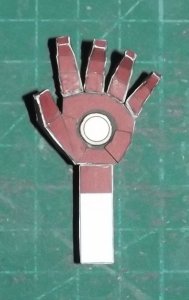

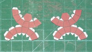

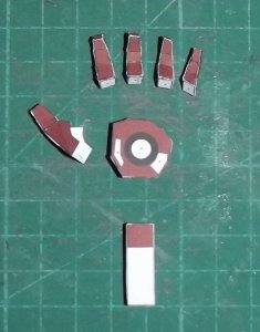

Here are some close-ups of the left hand. Despite their small size the parts can be assembled easily. There are optional parts for a closed hand available, too. I will present it here, too.

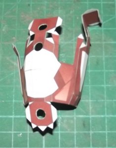

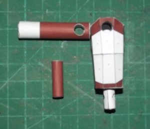

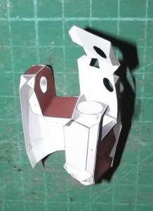

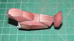

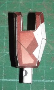

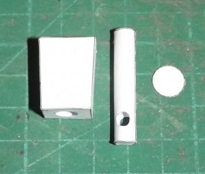

And this is probably the most tricky part of section 2, the upper arm. Therefore I give you some more detailed pics which might help with your builds.

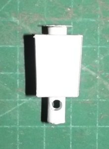

First you have to build a little box and put a tube with two holes and a stopper inside.
10,092
9,717

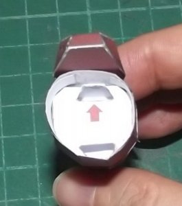

Then cut out the outer shell of the upper arm. The little box has to be inserted into the shell, so keep in mind to leave at least one side of the shell open when you assemble it. Take a look at the pictures.

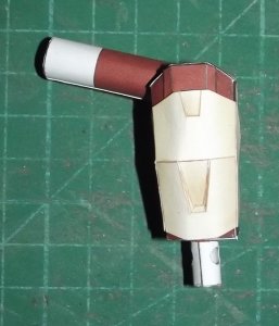

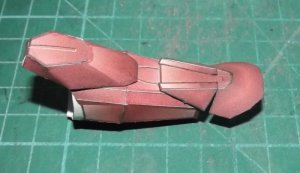

Then comes the upper arm joint. It consists of two tubes which are pushed inside each other as shown. It is easier to slightly roll the small tube when you push it through the holes.
10,092
9,717

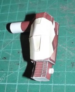

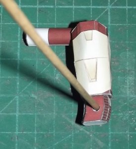

Attaching the lower arm joint requires a rod, shashlik stick or tooth pick. The elbow box features two small holes which have to be aligned with the holes in the upper arm box tube so that a connecting tube can be pushed through them. Push the rod through the holes and pull the (upper arm) tube a bit downwards so that all holes are aligned. Then roll and push the (connecting) tube through the holes.

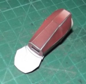

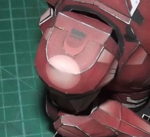

A little note concerning the shoulder protector: You have to cut two little triangles out to be able to fold it as intended.

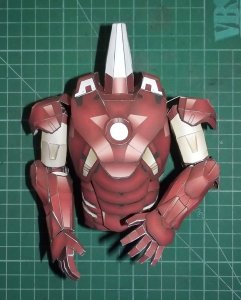

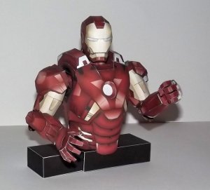

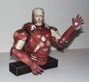

The upper body is now complete and the figure is taking shape. Any visible white edges will be painted later.

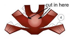

Hip, hip hooray!

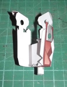

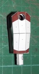

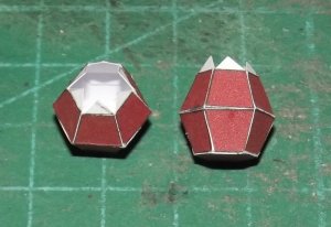

Now here comes the hip and pelvis and we start with a big mistake in the plans. The two balls which hold the upper legs in place do not have any flaps where they connect to the main tube penetrating the pelvis. You have to add them yourselves BEFORE cutting the parts out. The picture shows how they should look like.
