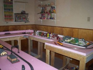

I think what my problem is...besides being new at this..is that I don't have a vision of what I want my layout to look like when it's done. Yea I know...it's NEVER done. If I had all the room..I'd build a layout that was a 30 foot by 3 foot modular layout like I've seen at the many train shows I've been to. I've also seen smaller double helix layouts, but I don't think I'm capable of building that. I don't want a train that just goes around a circle and I don't want to win an award for the best layout ever.
Ed

One of the reasons a RR layout never seems to be finished is because that 'vision thing' keeps changing as time passes by. You will see many folks who have finished the benchwork and laid track, but never get to the scenery because they are more interested in RR operations then they are in completing the layout.
You have an excellent start, now comes that 'vision thing'. You bought a bunch of stuff, I'm sure, because you could invision it on your layout. So take some large lined graph paper, or use a PC graphics program, and lay out your benchwork keeping it generally to scale. Next divide your layout into sections or areas. It appears from your initial layout that you want a continuous run that can be single track or dual track so you can operate mutiple trains going in different directions. You have two end areas on your layout that will provide loop backs for continous loops. If desired, you can use switches and make one or both the main tracks into reverse loops. Perhaps you want a staging yard. Either one of those thinner longer areas of your layout would handle a small staging yard. Perhaps the other of those long, thin sections could be what is called a 'time saver' with scattered small industries for incoming and outgoing rail deliveries. On those other two bulbus areas, perhaps one could support a turntable, roundhouse and steam/diesel maintenance facilities. On the other, perhaps some mountains with with either a saw mill complex or mine operations.
The point is to plan out what you want your layout to look like and then sketch it out to make sure whether it will all fit or not. If not then buy a bigger house with a bigger train room - not really <BG> You have obviously seen a lot of layouts on the web and perhaps certain ideas you would like to have on your own layout. As everthing has a footprint you should be able to sketch something out to see what fits and what doesn't. A saw mill can be 3' X 5' on the large size or 1' X 2' or less for a smaller version. Same with an ore mine.

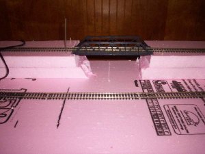

It seems that for every 2 steps forward, I fall 1 step back. In reply #20 I have pictures of my flex-track joints. I joined about 10 pieces together and started laying them. How can I temporarily hlod them down? I tried 2 different types of pins, but the couplers hit them. Besides just flat head pins (which I don't have right now) any other suggestions????
Ed

It's difficult to tell from the photos exactly what method you've used to join the sections of flextrack, or the brand of flextrack. Atlas flex has holes moulded in the centre of some ties, but you need to open them up from the underside. Atlas also makes blackened track spikes, and if you're using foam as the roadbed, simply insert a spike in a suitable hole, then push it into the foam using a pair of pliers. This will hold the track in place until you add ballast, and until that time, it's easy to pull the spikes and reposition the track if necessary.

The flextrack is Atlas. I slid one rail back and feed a slid out rail from the next section into the first one, thus "joining" the two pieces. I did this with all the track. I bend a piece of copper wire into a --u-- shape and solder it between the joints. I did try pins to hold the track down, but the heads stuck up too high. What I need are long pins with flat heads. Kinda like a gutter spike or 16 penny nail BUT pin sized.
