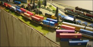

I made several of these from Norbtach's pages about a year ago. It is nice because they already have a weathered look to them. I will probably have to redo them soon as they are getting pretty beat up. I also learned how to make my own so I made domestic sized containers. Unfortunately, our tunnel module was made by a Canadian, so domestic containers do not fit through it. :-D International ones fit just fine. I took the graphics and combined them into one to make the double stacks.
Containers

Jesso, are those all paper containers? They look great man, i should have printed more. Too bad not many choices in N scale.
Sorry for double post, i cant seem to edit my previous post. Just found out that if you reduce the HO scale PDF files to 54%, you can get close to N scale.
All of my containers are cardstock paper and they all came from the first link. The graphics have to be worked more on Norbtach's than on the other one, but that was actually better for me the way I did them. Norbtach has a much bigger selection of containers, and I wanted to have as many colors as I could on my trains.
