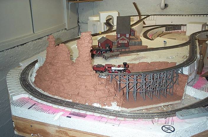

Here's a pic of my first atttempt using ceiling tiles.
I broke them up into pieces about the size of my palm and glued them in place using LN for foam projects. I then scraped them with a fork to blend them together. Next came a heavy cost of KILZ primer, then latex paint. I did have to fill in some voids between the pieces with joint compound. I also inserted an 1/8" dowel into the tall spires for support. Next comes some more coloring with washes and chalks.
