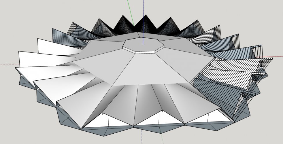

Here's the Concourse B roof roughly halfway complete. First step was to establish the plan view... it's a 7-sided figure with each side divided into thirds. All of the ridges and valleys radiate from the center. The peaks and valleys transition smoothly into a flat slope going the rest of the way up to the top. The slope down from the top continues straight, uninterrupted, down the valleys. Therefore, the sides of the peaks aren't flat planes but are actually "twisted" along their length, so I divided the peak and valley lines into 16 segments and spanned them with a web of transverse lines. Next step will be to divide each of those resulting 4-sided spaces into triangles, allowing faces to be created, then smoothing. One near the lower center of this view is completed as a test to decide which way the diagonals needed to run.

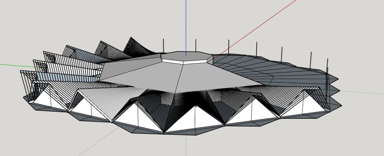

"Skinning" of the upper surfaces of the roof peaks is well underway. After this is complete, the next step is to clear away the leftover parts of the plan view that were used to establish the alignment of the roof outline but are no longer needed, then to skin the outer edges and under surfaces of the protruding peaks around the edges. Then to build the rest of the structure downward. I did the roof first as my measurements from Google Earth were over the edges of the roof, and the walls are inset from the edges. I felt it best to start with where the most accurate measurements are, than to start from there and attempt to work backwards into the rest of the structure, then do the roof last.

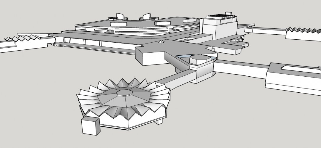

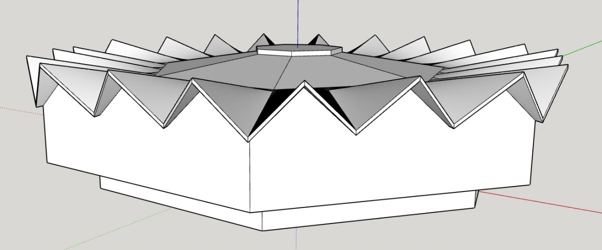

The major 3D work is FINISHED!!! Only a few minor details to go back and add... air conditioning units and that sort of stuff. But the major design work is done and the focus will now turn towards generating the paper design templates. But I suppose that will be better served with another thread. I am going to need input from a few designers because I'm sure everyone has their own approaches and my goal is to get an accurate design with as little clean-up work from my end as possible. And I would like to have the possibility of having professional-quality PDF templates to possibly sell.

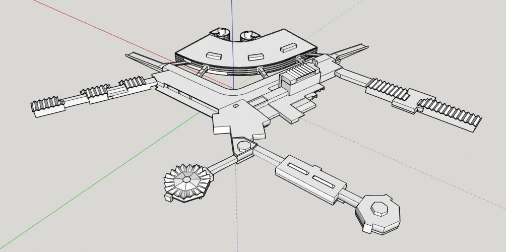

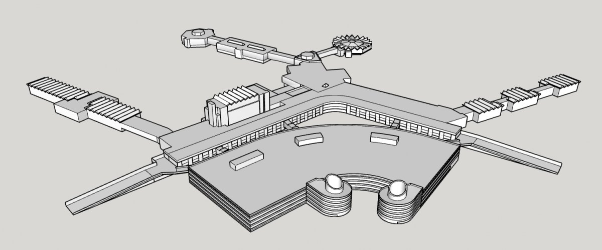

And now for a concourse! This is Concourse A, which housed TWA and Eastern in the heyday, and Northwest's "focus city" operation at the end. There is no need to model the jetways at this stage, as those will be based on a ready-made design and installed at the time of construction.
Lots on greeblin/enhacing possibilities to make surface 3d here.
Reactions: Awry_Chaos
