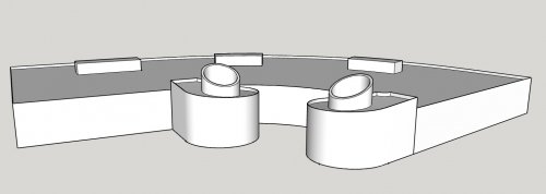

And here we have the entrance/exit ramps built and attached. The ramps extend above the top of the garage because they were intended to accommodate a further expansion of the garage which never materialized. The parking garage itself is now complete as far as the 3D design goes. I do have a concept for a more detailed version of the ramps but I'm concerned about the technical feasibility of physically executing it in 1:400 scale.
Still to be added... the office/pay booths (it resembled a highway toll booth as far as I can remember), and the two road and 3 pedestrian bridges that connected the parking garage to the airport terminal.

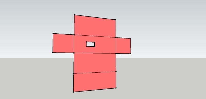

When you have set the correct position you should do this:
Select both shapes. Go to Edit - Intersect - Intersect with Model:
Both shapes are cut to pieces where they meet:
Delete the bridge parts sticking out of the garage to edit the garage only:
Right-click on the rectangle in the face - Delete:
This will create a hole in the geometry. When you unfold the shape it will look like this:
The hole can be used to position the bridge.
One thing is very important: When you do these kind of operations ALWAYS WORK WITH A COPY. You will need to edit the bridge part separately later in a similar fashion and if you do not create a copy you are in danger of overwriting and losing the original. ;)
