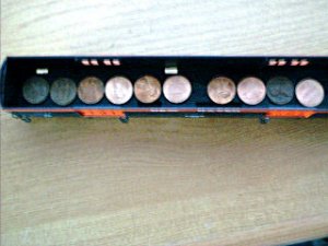

There is a major flaw I have found in them. Others may have too, but never posted it here. The flaw is, weight! There's NOT enough!
Mine likes to derail. Here is a solution I first did.
First time I taped nuts inside the cars. I taped them because I knew in the future I wanted to add the "guts" and lighting.
Then I experimented on the coach car. The nuts had to be removed. It derailed because of lack of weight!
I added a Walther's interior light. That pretty much solved the problem, but modifications to the trucks. Prevented me to use it.
Finally, I added some old weights from old Tyco trains. After I add them and the "guts", I couldn't put the roof back on!
The "glass" for the windows is attatched to the roof.
For those who like super detailing. You will be spending ALOT of time detailing it yourself!
My advice is: These are excellent projects for the moderate or expert modeler. As for the beginner or lazy modeler (like myself
) I would go with Walther's, Athearn, or some else.
I do have two sets. I wont be getting rid of them. I do use them, but in the future I will buy Athearn or Walthers. What will I do with the IHC? They can set on a side tack at a station for passengers to be boarded.
I would like to hear from those who have IHC. What have you done to solve the problem?
