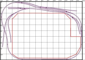

NYCentral
Aug 29, 2002
249
Albany, NY
How about something like this, everything is within 2' reach. Again this is just a start or a basic idea.
there would be a 4" wide shelf above the stairs, which shouldn't affect their usage.

Aerion
Dec 18, 2002
9
62
Columbia, SC USA
Originally posted by Railery
At the top of the stairs u can build a 4' loop and continue along the way. That gives u 3' to get by. u can make the loop a mountain area with a curve trestle. So when anyone is coming up the stairs they will see the trestle and the mountain terrain. :)
One of the problems I'm battling is accessibility. If I have any place against the wall that is 4' deep, I will have a hard time reaching it. Anything over 36" is going to be too much of a stretch.

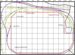

NYCentral
Aug 29, 2002
249
Albany, NY
Originally posted by Aerion
I think you're on to something with the track running over the stairs, NYCentral. Let me ponder that for a bit. Thanks for the suggestion!
On your example, which tracks would be lumber company and which tracks would be freight line?
I fine tuned it a little.
Yellow track is logging
grey is freight
black lines are roads
blue is mill pond
in lower right corner (above stairs) is a small town
numbers are elevations in inches of the track.
Logging grade is about 3%

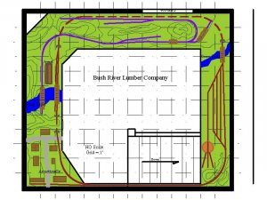

First Cut
Ok, guys. It is still a work in progress but this is my first cut.
The logging camp will go in the top right corner. I'm still bouncing aroung what to do with the staging yard on the right side.
Opinions please!
