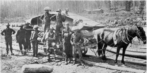

What I would do
I would figure out some way to attatch another set of wheels on the outside of the present ones, only these second set of wheels would be put on with the flange out. This would give the "U" shape that is so unique and allow the thing to run on timber rails like the prototype. I would have the engine pull a load of logs and hide batteries inside the log load that would power the engine. I would get one of those micro radio controle cars from Radio Shack and use that to controle the motion of the thing, start and stop. Gear it low, one speed forward and reverse(dosen't have to have a reverse) line the traction surface of the wheels with strips of sand paper to help give it traction on the timbers.
If you know someone with a laith, then you could have then turn you some real cool wheels out of brass that would look even better.
I think the real challange is to make the thing run on wooden rails just like the prototype did.
You could make a static display in your camp with a rig like this.
Note how the rails are joined together to transfer the weight.
