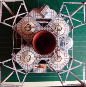

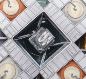

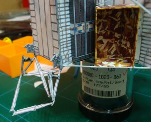

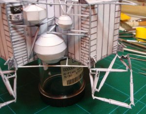

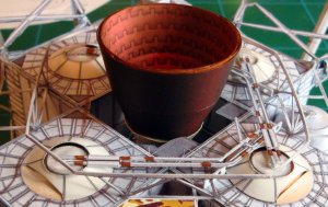

But, before, I have to fix a little damage that I inadvertently made to my LM. Take this as a warning if you want to build this model. I used to let the descent stage to sit on his big engine, until the legs are ready to do their work. Big mistake! Doing this way all the weight of the model was loading on the thin card stripes that fix the engine to the walls. As a result they became badly distorted.
:eek:ops: Not a nice view isn't it?
So I first found an alternative support for the model (a glass jar just little bigger than the square opening in the center of the stage, so it cannot damage underside details), then I moistened engine mounts with a generous amount of white glue mixed with water and placed a weight to keep the strips straight.
After an overnight drying the engine looks much better

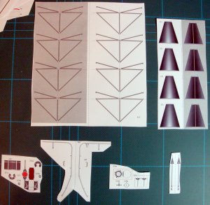

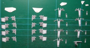

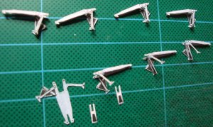

There are a lot of very tiny parts. With a fine ink pen I drew the inside face trying to replicate the outside pattern.
The pieces are very little and fragile. I don't think they can resist a lot if you play with the retractable landing gear, I think I'll glue them in extended position as soon as the main legs are ready.
Anyway, working or not, they are really nice! :)

Get some wire, piano, drill a whole lengthwise through each strut, the fill with crazy glue, pass the piano wire (be prepared to wipe up what the wire pushes out. That should support it fine. Or, get a small round tube of Lexan, a very thin diameter would work, and stick it in the engine, and into the stand that will support it also. My two cents worth. :)

Thanks Zathros, now this particular damage is fixed and soon my LM will stand on his legs so I won't touch those struts anymore but your one is really a good idea and I'll keep it ready for future use. Believe me: ALL of your many advices are carefully stored in my modeling database, as for all the countless ideas I keep finding here at Zealot from the great builders that are all around here.

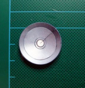

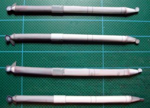

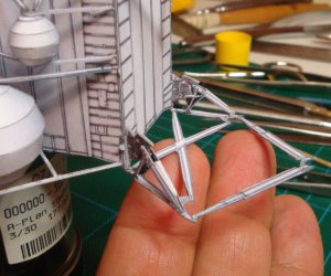

Main pylons: a really hard work to me. The tubes, after glue has hardened, tended to warp badly toward the joined side. I had to carefully straight them with my fingers with the fear to see them fold suddendly if I pushed too much.

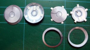

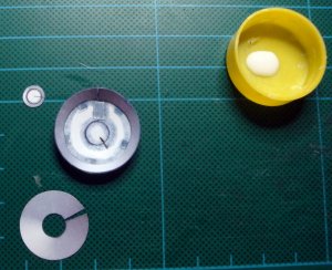

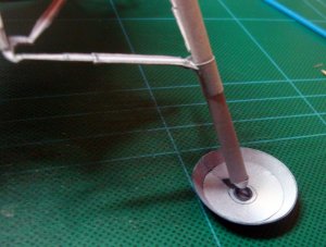

The landing pads: as usual I prefer to join curved pieces with little tabs. I first builded the lower side. Then I added the upper parts, one at a time, using the same lower tabs as a support so I won't add too much thickness between the layers. The final look is pretty fine (thanks to UHU design skills).

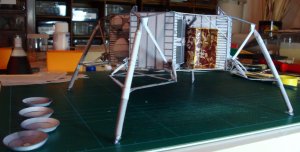

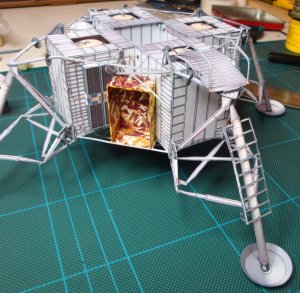

The landing gear, after adding parts 308a and 308b, they are ready to accept the main legs... after I'll have succeeded to straighten them

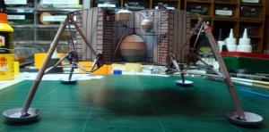

The legs are finally glued. At this time I fixed with glue all landing gear elements because I don't want it to be retractable (as I said before) sacrifying this playful feature to a more solid assembly.
My main concern at this time was about the moment to put the LM on his legs. As you know a body on 3 legs is naturally stable. If the legs are 4 the thing is not so straight. If the construction is less than perfect one of the legs will inevitably finish to float close to the ground without touching it. This is the moment when I decided that UHU is the god of paper models! The four legs was lying on the table perfectly aligned. No adjustment was necessary!!! This model is really difficult to build but so perfectly designed that the success is guaranteed! Thanks UHU!!!!
And now let's put on the new shoes!

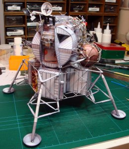

WOW! What a nice view! Finally it stands! How long I was waiting for this moment!
I couldn't resist one moment more: this is the time I was waiting since I concluded the ascent module build...
THE MARRIAGE!!!!!
I stayed sitting in front of this object for several minutes (I don't know how much) I could not believe I did it... It's almost done, only some more details and adjustments to do but the great part of the work is done. Time for a beer! Time for a great beer! One of the "special" ones I have for special occasions! :Drinks:

:surprise::surprise::surprise::surprise::surprise:
That looks f*****g amazing!!!!!!!!!!!!!!!!!
A very proud moment for you, and so it should be ..... WOW!!!
:Bravo::Bravo::Bravo::bowdown::Bravo::Bravo::Bravo:

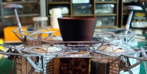

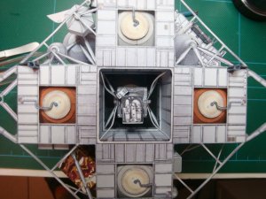

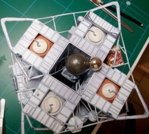

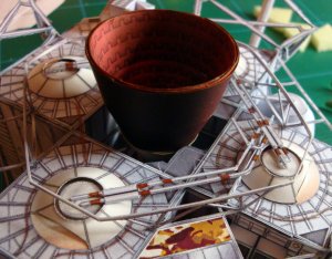

Now I finally can take out of the box labelled "to be glued later" some of the parts that couldn't be placed before. I was waiting for the legs to be "on duty".
This time it's the turn of N°269 (engine tubes) and N°264 (the protection guard which I carefully cut away all the grey triangles, remember?).
They give a lot to the look of underside. I should put a mirror under the model when it will be completed to enjoy all this stuff.

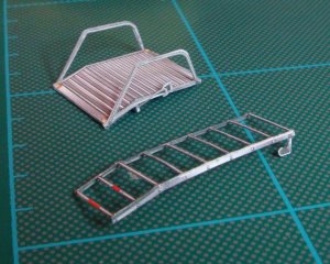

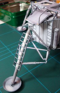

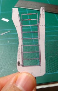

The last pieces of the "naked" version, according to @uhu02 's sequence, are the ladder and the egress platform.
Two nice little things to be cut very carefully.
This particular fold is, I think, one of the most difficult I ever made in my career. The paper stripe next to the steps is well below the millimeter.
As I said more than one time during this build, I prefer to cut separately little pieces to be laminated. The probability to have a wrong alignment on so little pieces is too high. I prefer to do some surgical glueing after...
OK, the path to moon surface is ready. And now?
This should be the end of the build if you don't want to cover this beauty with the external skin (like me).
