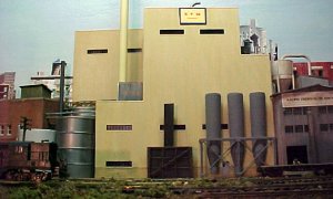

I tend to view any kit as just a collection of parts that with a little imagination, will turn into something original...
I would LOVE to get my hands on one of those refinery kits!
Here's a chemical plant I kitbashed for my N scale layout...
The large tan-colored building is part of the Walthers Superior Paper Co. kit. I've made two decent sized factories out of this kit, & still have lots of leftovers.
This would be a great starting point for a power plant...There are TONS of detail parts with this thing!

Thats a great addition to your layout Charlie. Nicely done.
In making larger buildings I have used wood, foam, masonite corrugated cardboard , left over plastic vertical blinds and MDF board.
Just about anything will do. Depends on what I have on hand.

Charlie, is that chemical plant kitbashed form the Walthers HO Kraft mill? How's the railfanning in Louisville? I bet it's crowded there with the derby coming up this weekend.
Drew1125
Jan 28, 2001
2,975
Hi CSXFan!
The model in the picture is N scale...Like I mentioned, the large tan-colored building came from a Walthers Superior Paper Mill.
The metal building to the right came from Walthers New River Coal Mine kit, & the brick structure on the other side is made from DPM wall sections. The black incinerator is made from pievces of the coal mine floor, the 3 gray silos are little water vials from a flower shop, with legs from the coal mine kit, & the tanks came from both HO & N scale Walthers Interstate Fuel kits.
