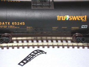

I purchased two of these N 17,600 Gallon Tank Cars and as I picked one up the ladder popped off :curse: I noticed there are little pin holes for the ladder to attach too. The ladder does stay on it's own but I'm afraid that it will fall off and get lost. I assume these are glued at the factory. What type of glue should I use?

I'd suggest putting a drop of CA for plastics on a piece of wax paper, using the tip of a pin or fine needle, dip it in the CA, and then put it in the holes. All you need is just enough to "wet" the inside surface of the holes. Put the ladder in place and let it dry. If you use too much, you'll have residue to clean up, and might end up with the whitening around the attachment points.
