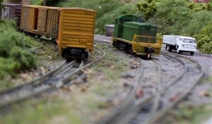

I got rejected from Model Railroader

Those are better looking than some of the stuff they do publish.
Some people just have no taste...:rolleyes:

There are no people present in my scenes.
I took with a Kodak Easy share digital camera (bargain type)
I did include modelling notes & story..mostly woodland scenics terrain, lifelike engine, etc
thanks for advice.:thumb:

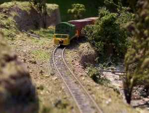

CNJ999
(layout scene I shot using an 18mm WA lens at an f/27 setting)
