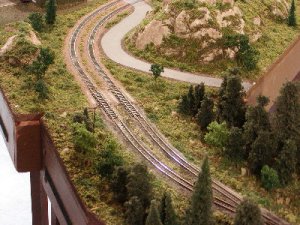

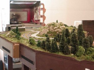

A couple of years ago, I was talked into building a corner module for a member of our Victoria oNeTrak club, Later, I decided to build an offset module to match the club honcho's module and decided to match my module (Carpenter Creek) with Dave's (Stark's Bend) Corner for a continuous scene.
Unfortunately, I goofed in matching up the mainline and siding tracks, resulting in the two being off center by 1 1/2 inches:eek:

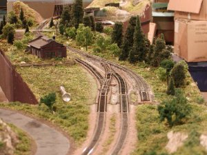

Fixing this little problem will probably involve the re-location of some scenery, which is OK, as it was not yet complete and it will give me something to do that I can post progress on.:D
Cheers!
Terry

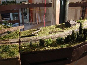

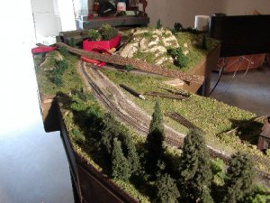

I thought of putting a transition module in, however, there was not much enthusiasm among the other club members to that approach, so I decided to re-align the track and add a couple of industries to the module.
The outer main will be the spur to one industry (any ideas?) and I decided to re-activate the old factory that had the abandoned track, by running back from the new siding and joining onto the abandoned section of track and leaving most of the abandoned section to the main line as it is.
here is my progress so far.
Cheers!
Terry
BTW, It sure hurts when you tear up scenery

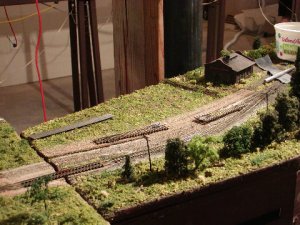

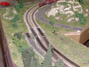

K.V.Div
May 11, 2001
625
66
Shawnigan Lake, B.C. Canada
Putting in the new industry near the edge will be next, followed by re-activating and detailing up the old factory.
Then, rebuild the scenery and if I feel charitable, I might just add some more detail to dave's corner module.:)
Cheers!
Terry
