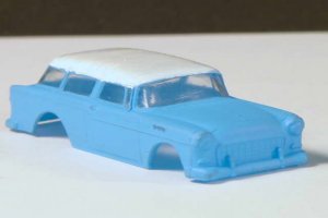

Some time ago (after the backup and before the crash) I posted a question about how to paint those tiny Williams Bros HO vehicles, as I had a problem with the paint kind of peeling when painting the second color (white) on top of the base color (blur).
Well, after some searching, I got to the conclusion that I had to wait more than 24 hours before brush painting a second color.
So this time I waited a week!! and still when I started brush painting the white, the paint started to peel, so I decided to air brush the roof instead, but didn't get a good result because of the pain bleeding under the masking tape. I know it's my fault and I can blame that mistake on the paint.

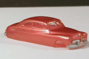

The second car I did was the red one, I'm kind of satisfied with the paint, gave it 3 coats, and the paint came on nice and smooth, so I thought that I finally figured out how to use the paint, 1:1 paint / thinner for airbrushing. So on to the next one, first coat went on nice and smooth, waited 24 hour for the next coat, DISASTER!!, on one side of the car, the paint is nice and smooth, on the other it started to lift/peel??
Ok, I give up, no more painting with Testors Enamel paint for me, back to acrylic (I think).

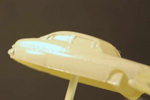

and this close-up of the beige car shows where the paint has lifted a bit. It's weird that it's there and on the back, the rest of the paint looks ok.
I can't decide if I should strip the paint from the blue and beige car and try again, or if I should just finish them, and just make sure to place them correct so they show their 'best' side.

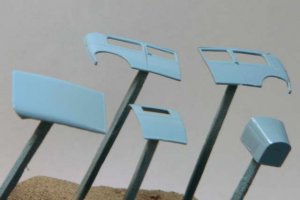

I'm currently working on 2 Jordan kits and this time I used grey Krylon primer, so let's see how they come out. I will post a picture now matter what. I'm thinking of painting one using Poly S paint and the other using Testors, just for a test.
Also, this time I washed the body parts in warm soap water, and are now wearing latex gloves when handling the parts, lets see if that helps.

This one was painted using gray primer and some light blue spray paint I bought at Pep Boys today. It's so much more convenient to use spray paint than using the airbrush (if you can find the color you want), no cleaning of airbrush or paint bottle, no mixing paint, no waiting 24 hours between coats. It to me a total of about 1 hour from the first coat until it was done, but only about 5 minutes actually painting, 1 coat primer, 2 coats of light blue. Easy.
