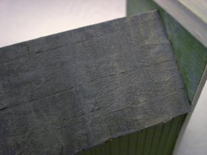

Another roofing material
Jesper, for this tarpaper roof I glued strips of a Kleenex hanky to the roof. Then I painted it with a wash of diluted flat black - in this case it was Humbrol enamel color. (Acrylic colors should work just as well - take care of warping however, when the subroof is cardboard or wood!)
When it was dry (!) I got myself some plain, dry dirt from the road gully in front of my house. I dipped my finger into that stuff and then I rubbed the powdery dust into the tissue in more or less vertical strokes (like water would wash down the dust from the roof).
Finally I moisted a brush slightly with water. Do not load the bristles with too much water - do as if you would drybrush on a color! Then I went over the whole roof again. The water settles the dirt particles definitely into the pores of the Kleenex tissue - and there they stay! No need for Dullcote or such a stuff, and the color is and remains dead flat.
As usual for new methods, you might try it on a piece of scrap material first. Perhaps you like it? :)

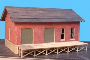

Hi, Jesper,
I just saw your PM and question. Sorry I didn't respond sooner.:eek:ops: I never remember to scroll to the bottom of the homepage to see if I have messages. :rolleyes: :eek:ops:
First off, I used two different materials for the tarpaper on my freight houses in the thread you cited above.
For the DPM brick freight house, I used black construction paper. Before cutting the paper to scale width/length, I painted it with Americana's "Celery Green" acrylic craft paint. I made no attempt to paint the paper evenly or thoroughly. After cutting and gluing the strips to the subroof, I dusted the entire roof with a couple of different shades of Rembrandt raw umber chalk. I may also have used some Rembrandt gold ochre also, but I'm not certain about that at this point in time. (BTW: I never use any sort of fixative with chalk weathering. If some gets smudged off, I just reapply the chalk later.) The final step was to "distress" and tear the tarpaper with a wire scratchpen in a few "strategic" spots.
For the scratchbuilt wood structure, it was a much simpler process. I simply spraypainted a piece of newspaper (probably from the Want Ads :D ) with Floquil's Roof Brown. After it dried for several days, I cut it to length/width, applied a glue stick to the upper half of each strip, and pressed it down. The final step was a dusting of the raw umber chalks and some tearing with the scratchpen.
All in all, it was fairly simple. I hope I've been able to answer your questions.
