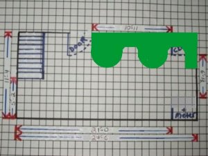

Here it is...the compromised bench plan. This plan can be expanded later as the opportunity presents itself. Both peninsulas are 4'-0 across and 5'-0 out from the wall. I'm keeping the aisles 30" (+ or -) wide. the bench height is going to be 40" high to make it possible for the boys to help without it becoming a hassle. Because of the size of the radiuii, I'm guessing steam is not really practical so modern era is probably way to go. My oldest has expressed an interest in a coal mining theme on at least part of the table. Continuous running is a must but I'll need switching and or a turn-table to keep interested i believe. some elevation change would also be hoped for. That's what I'm thinking... any questions or help will be appreciated. P.S. I fought for the original plan but was out-flanked.

It looks like those peninsula's are about 4' across. That would support a 22" minimum radius. A 22" radius will allow the operation of small steam, probably up to 2-8-2 freight locomotives and 4-6-2 & 4-6-4 passenger power. One warning though, steam engines are very delicate and not really appropriate for small children. If you are going to model in ho scale, f-units woudl be an excellent choice for the little guys until they get big enough to take care of the equipment. Bachmann makes some nice f-t's, and f-7's with 8 wheel drive. Athearn r-t-r f-units , or Lifelike p1k f-3's would all be good for kids. You could also look for some of the older Athearn switch engines at swap meets or train shows. The modern Athearn r-t-r switchers would be ok, but they come with plastic hand rails installed and may be a bit delecate. The up side is that if the plastic hand rails are broken off, the locomotives could be run without hand rails until the boys are older and then you could install brass stanchions with hand bent wire hand rails.

Actually, modern era is not in general a good choice for limited space and smaller radius curves. The earlier the era, the smaller the rolling stock and locomotives, and the shorter the trains (if you care about being prototypical - it's not a requirement to enjoy the hobby!). The only exception to the rule happened in locomotive size with the switch from steam to diesel. Diesels do look better on sharp curves than later era steam locomotives. But 1st and 2nd generation diesels were considerably smaller than present day diesels.
For small steam, small cars (frieght cars were just reaching 40ft in 1910), and shorter trains, before 1910 is your best bet. However, there's not a lot commercially available. Early diesels is your next best bet (F's, early GP's, SW's and their non-EMD equivalents) because car and train lengths really started to grow in the '60s. In the '50s, 40ft cars still dominated. Engines had 1500-1800 HP instead of todays 3600+ HP.
However, the issue of era is mostly personal choice (if you even pick an era). Your boys may have particular desires to see very modern equipment, but then again they may be happy with an older era, too. There are quite a few of us who happily model eras we never saw in real life.
