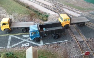

I use the backside of asphalt shingles, no coloring involved. Weathered with pastel chalks and sealed with Dulcote, I use paint pens for the lines.

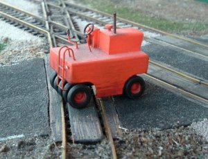

TruckLover said:
:wave: Hey shaygetz, I use sand paper and I can see the seems where one peice meets the other. Does your asphalt shingles do this to?
SSsssssshhhhhhh...only if I let them:thumb:
What I do is cut inwardly at each joint so that they meet almost perfectly invisible. If you look at the grade crossings you'll see where the others show no seams as I developed the technique.
Here's another shot, showing the lines I do with paint pens...BTW, that's a little used branch line that the locals seem to favor when they bust a pose with their vehicles:rolleyes: :D
